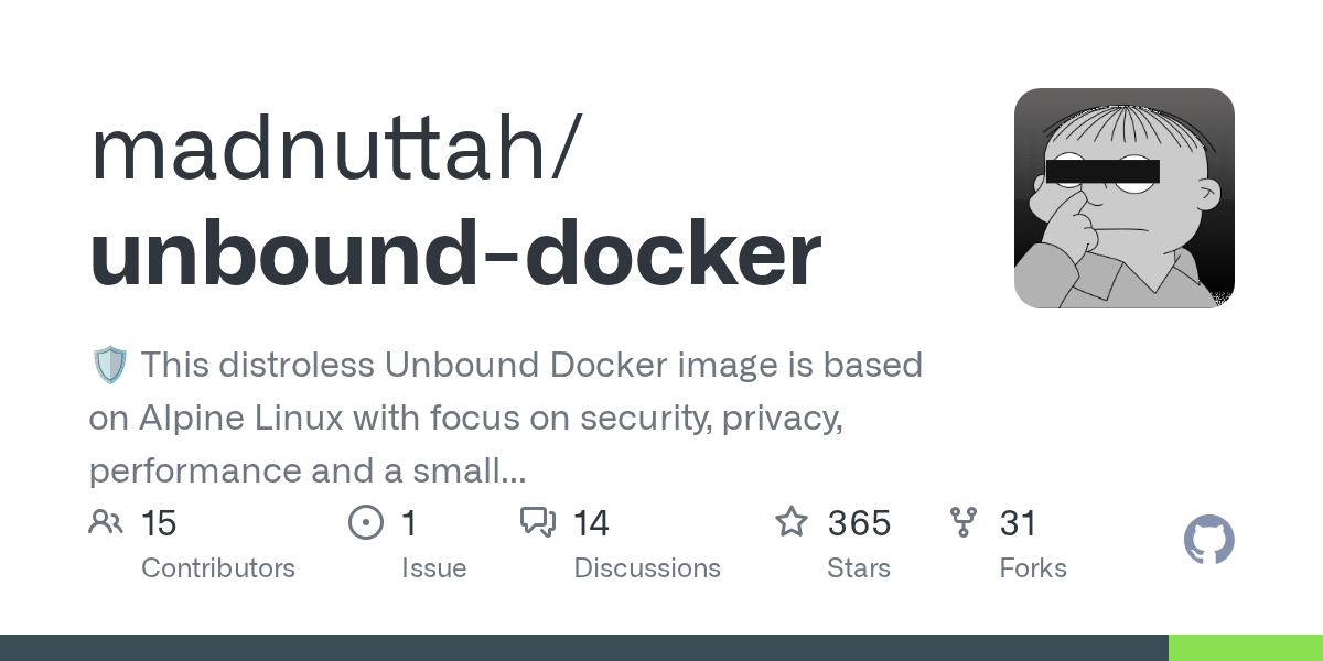

Actually I found another solution for me. I used a configuration in which pi-hole uses a macvlan like before, but also a bridge in a different subnet. I then specify the DNS of the container as well. Same goes for unbound. This has the nice effect that I can route the host of the Container through Pi-Hole as well and my tv and my phone, which only did a connection test request through Pi-Hole and then vanished with their requests.
I will post the guide from GitHub soon. I don't even know why I didn't stumble earlier about this guide. I can't imagine how many people are using Pi-Hole wrong.
