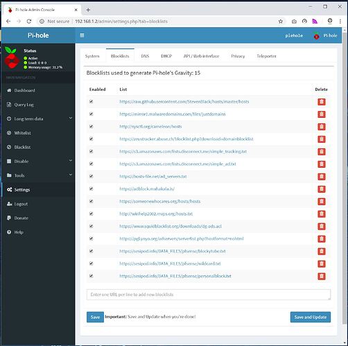

Hello all I am trying to add Blacklisted wildcard domains using the Block List section.
This would be nice so that I don't have to add them all by hand I can just use a txt file hosted on my web server to add them all in one shot.
Here is part of the full list of domains that I have.
I would like to just use a one line wildcard in the txt file. Is that possible ?

I have a locally hosted .txt file with a bunch of domains that I have added to the Gravity listing.
I would like to thin the list of domains by using an wildcard domain in the list instead of 30+ subdomains.xyz.com

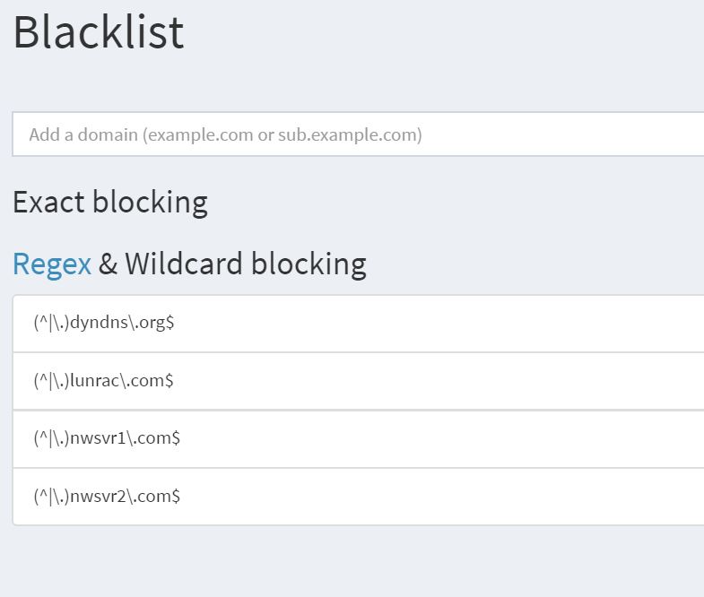

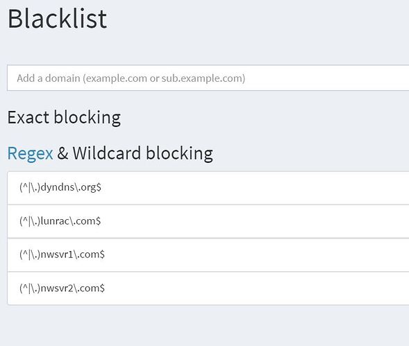

In the web GUI (blacklist), add your domain as a wildcard, and Pi-Hole will convert that to a regex expression for you and add it to the regex list.
Example:

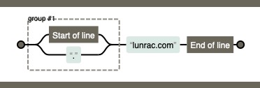

Add wildcard "lunrac.com" and this becomes regex (^|.)lunrac.com$. It would look like this in a regex diagrammer (https://regexper.com).
So are you saying that the List's that I have added to the Gravity listing will be removed?
No. I misunderstood how you were doing this. The way you have done it is correct. When gravity is built or updated, it will read your list and include your domains in gravity.
You can check this by searching the gravity list for one of your domains.
pihole -q , or through the web interface, or with a grep
sudo grep lunar /etc/pihole/gravity.list
But to your original question, you can put your list domains in regex format, and if that covers them all, then delete your local list from your block lists.

Okay so now that we are on the same page. Is there a way to add the wildcard domains to my .txt file that I have added to the Gravity lists?
I don't believe so. The file gravity.list is simply a list of domains, without wildcards.
You have essentially two choices:
  1. Leave your list as is and have a few extra lines in the gravity.list. That won't affect performance, as gravity is searched very quickly during a DNS request. Even if you had 1,000 domains on your personal list, that is minute in comparison to the 130,000 domains on the seven standard block lists.
  2. Put your list items into regex format, then remove your list from the block lists, or the domains will end up in multiple places (block list and regex list).

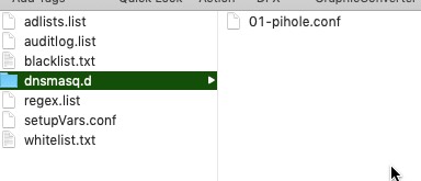

The lists are all in folder /etc/pihole.
The teleporter feature (web GUI > settings > teleporter) exports all the lists in an archive. You can save this to a location, then when the new Pi-Hole is up and running, import them from the network location.
Contents of a teleporter archive:

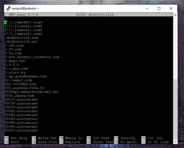

It seems like its all stored under gravity.list :thinking:

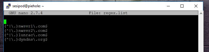

AH! Found it .... regex.list under /etc/pihole
So I just manually edited the regex.list under /etc/pihole and it auto updated the list on the web GUI so I guess this will work :stuck_out_tongue: :man_shrugging:
You don't want these regex items in gravity. Gravity works on HOSTS format (single domain per line).
So I checked the lists that I made and they are not added there so I remove them form the Gravity list using NANO and then re-updated the Gravity listing and it added them back :0 ?
Here are my lists.....
https://sesipod.info/DATA_FILES/pfsense/blockytube.txt
https://sesipod.info/DATA_FILES/pfsense/personalblock.txt
Update ---
I fixed the issue by removing my lists running an update then adding my lists back and updating. I guess it was caching the list.
