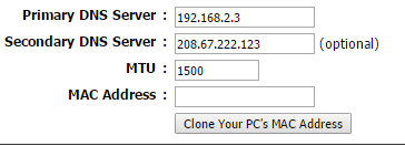

Send a screenshot of where you made this change in the router.
Stumped for now. I'll try again tomorrow
is it in some kind of death loop - pi tries to get dns from router, but gets sent back to itself...? but i assume that's the whole point. Alright - I'll wait on you (because i have no clue!).
