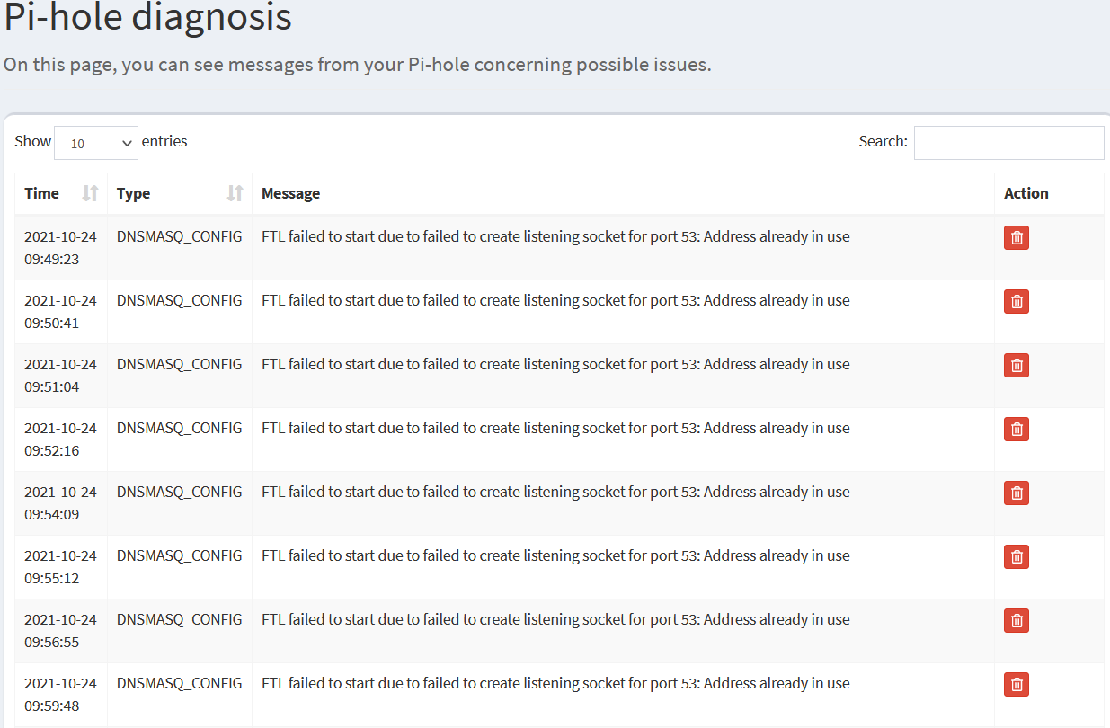

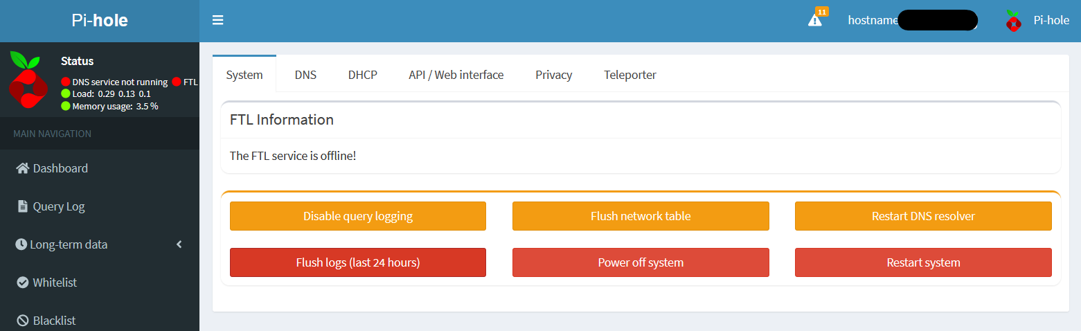

In the admin interface, I see this:
I noticed a bunch of notifications as well which have the following:
