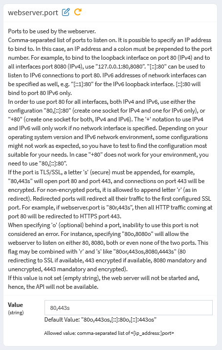

In that case edit /etc/pihole/pihole.toml and look at the ports = 80, 443os line and change it to 8888 or 8888s and then systemctl restart pihole-FTL :slight_smile:

Note:
Every v6 option is very well documented in /etc/pihole/pihole.toml and in the Settings > All settings page:

Next, as suggested, I changed to ports line to
port = "8888o,443os,[::]:8888o,[::]:443os" ### CHANGED, default = "80o,443os,[::]:80o,[::]:443os"
Have I got that right? I still have no access to the pihole web UI on http://192.168.0.100:8888/admin/index.php
which gives a 404
and https://192.168.0.100:8888/admin/index.php
says This site can’t provide a secure connection which is fair enough
/var/log/pihole/webserver.log reported
cannot bind to 8888o: 98 (Address in use)
cannot bind to IPv6 [::]:8888o: 98 (Address in use)
so in lighttpd.conf have changed
server.port = 8888
to
server.port = 8889
and restarted lighttpd
I now have access to the Web UI! :sweat_smile:
