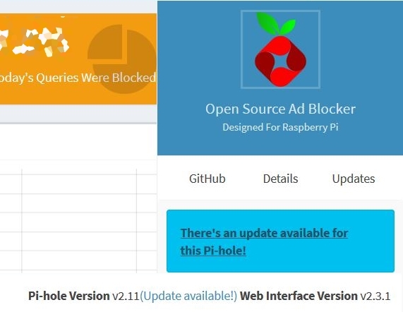

Update fails
I have the "Update Available" notice even after I manually run the 'pihole -up' command.
(Normally this is run once/week with a cron job)
Any ideas how to update?
[Edit]
When running manually there are no error messages or fails.
Everything states that Pi-hole is correctly updated and everything is up-to-date...
There is an existing issue (which should be fixed with this update) that causes non-english systems to fall over on the update script, not sure if this applies:
But try the steps anyway!

Thanks!
The commands in the linked article about non-English systems did the trick!
Looks like it's fully up-to-date now!
Thanks again!
