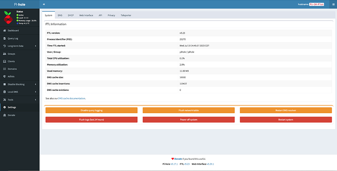

On the web admin GUI:
Select "enable query logging." The screen capture shows "disable" because I have it enabled. Yours will be the opposite.
That will take care of the query logging.
For the lighttpd enable, run pihole -r
and select the reconfigure option. In the menus, select enable the web server.
