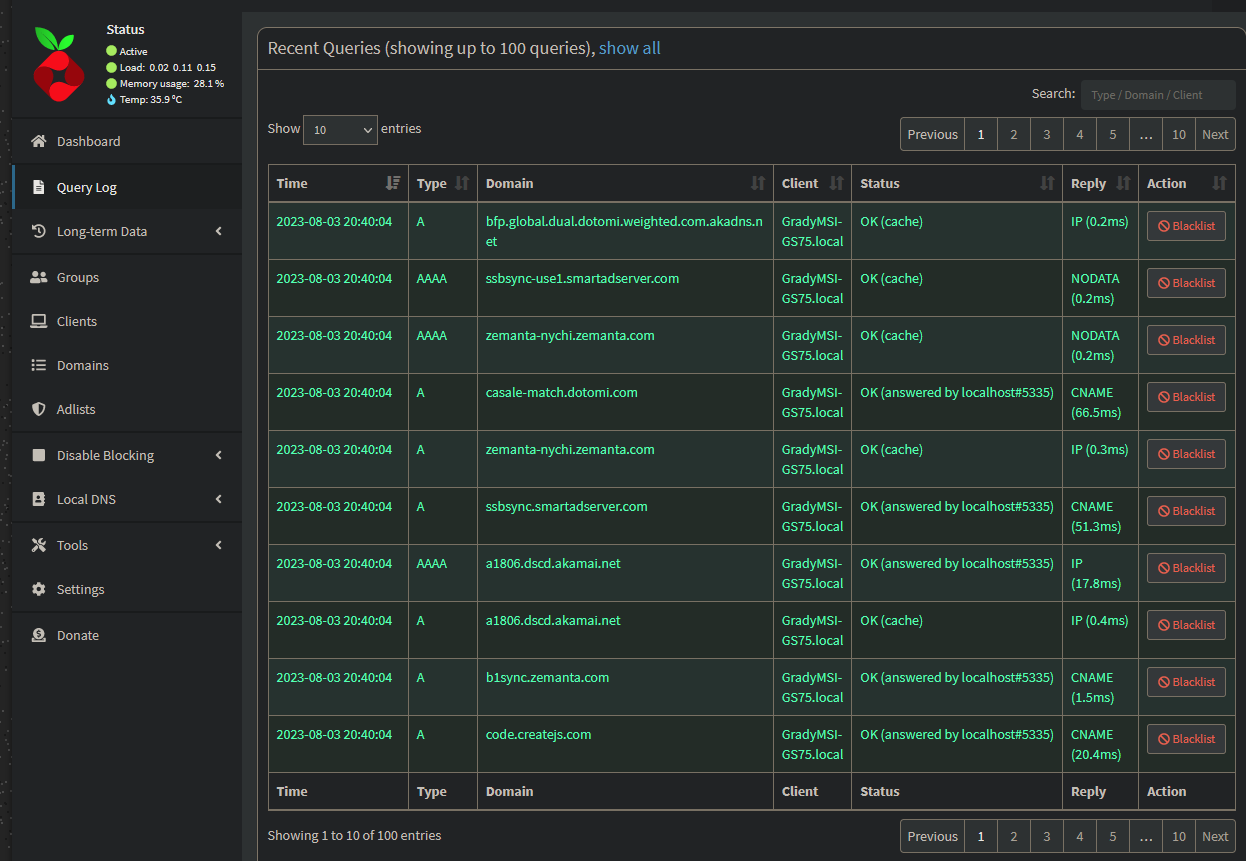

Okay, finished the install and ran this ad block test from my phone: Test Ad Block - Toolz
After, the Pihole query page had all of these:
Should all of these be being sent to localhost#5335? I would imagine these would all be blacklisted and not sent anywhere.

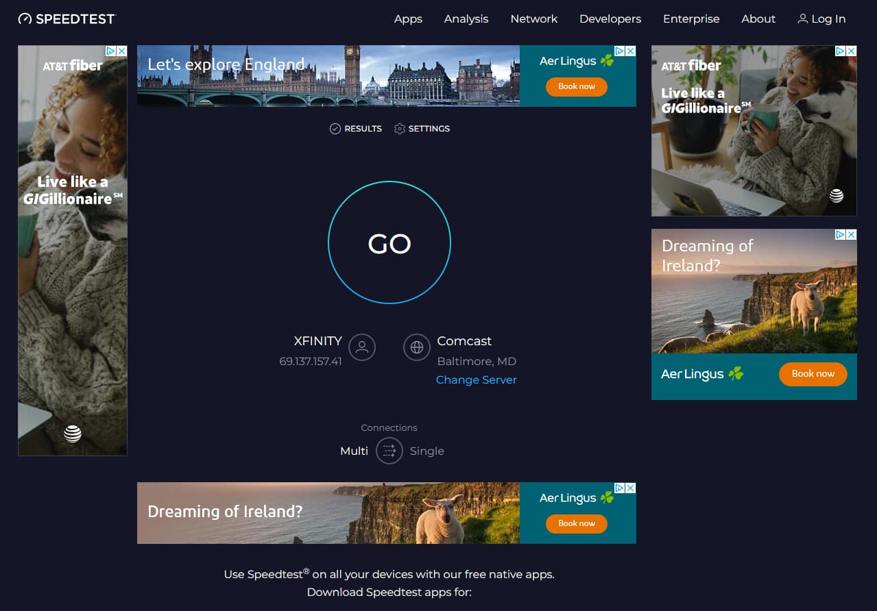

And just to double-tap on why I began this thread...
This screenshot is from a private browser window (Firefox - I used a private browser session because I didn't want the ads to be blocked by NoScript or uBlock Origin extensions) and the entire page is encircled with ads. Why isn't the Pihole blocking this? This screenshot was from my laptop that has the Pihole set as its DNS.

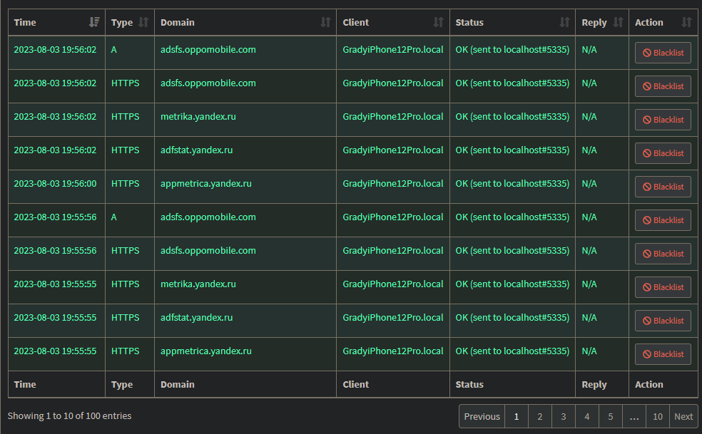

This is the same thing I was seeing on my iPhone earlier in the day where it just didn't seem like the Pihole was blocking anything, even though these entries are showing in the query log:
The first domain from the first screenshot should have been blocked:
pi@ph5b:~ $ pihole -q adsfs.oppomobile.com
 Match found in https://raw.githubusercontent.com/StevenBlack/hosts/master/hosts:
pi@ph5b:~ $ host adsfs.oppomobile.com localhost
Using domain server:
Address: ::1#53
Aliases:
adsfs.oppomobile.com has address 0.0.0.0
adsfs.oppomobile.com has IPv6 address ::
pi@ph5b:~ $ pihole -t
Aug  4 02:53:07: query[A] adsfs.oppomobile.com from ::1
Aug  4 02:53:07: gravity blocked adsfs.oppomobile.com is 0.0.0.0
Aug  4 02:53:08: query[AAAA] adsfs.oppomobile.com from ::1
Aug  4 02:53:08: gravity blocked adsfs.oppomobile.com is ::
Aug  4 02:53:08: query[MX] adsfs.oppomobile.com from ::1
Aug  4 02:53:08: gravity blocked adsfs.oppomobile.com is NODATA
