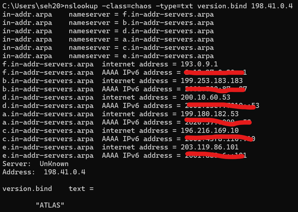

nslookup -class=chaos -type=txt version.bind 198.41.0.4
command and output on Windows:

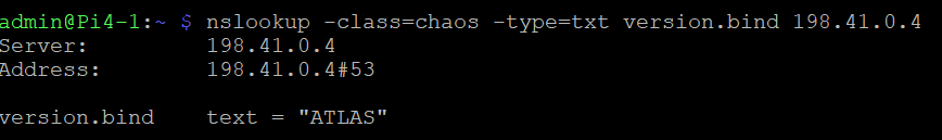

same command and output on Pi:

That command has nothing to do with IPv6 or high query counts.
It can give an indication whether your Pi-hole/network would be able to talk to the DNS root servers directly, or whether DNS traffic would be intercepted.
This would be particularly important if you'd run a recursive resolver like unbound in conjunction with Pi-hole, which must talk to authoritative DNS servers directly for DNSSEC verification of DNS replies.
You are seeing the expected result ("ATLAS"), so nothing interfering with those requests.
