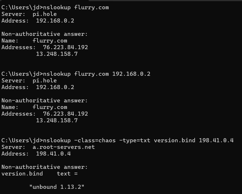

From that Windows PC, try asking it to resolve a known blocked domain and see if it is using Pi-hole.
nslookup flurry.com
Next try asking it to explicitly use Pi-hole (just in case it didn't).
nslookup flurry.com 192.168.0.2
Now see if you can reach external DNS without anything on the computer interfering, for example some anti-virus suites like AVG can do this. You should get the text response "ATLAS".
nslookup -class=chaos -type=txt version.bind 198.41.0.4
Your debug log shows things are working, your router is the DHCP server and is telling clients on your network to only use your Pi-hole, so the Windows computer above, and your other devices, should all be using Pi-hole, and you should see their queries in your Pi-hole Query Log.

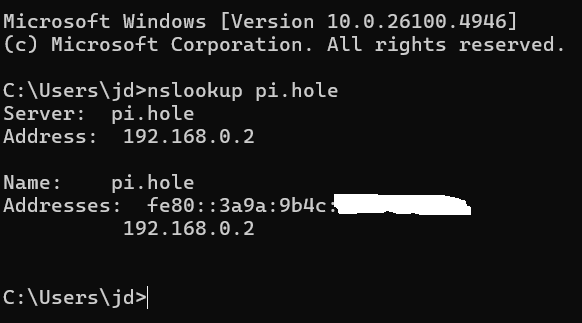

Below one queries for the pi.hole name to be resolved to an IP while addressing the DNS server(s) configured in the OS:
Output looks good.

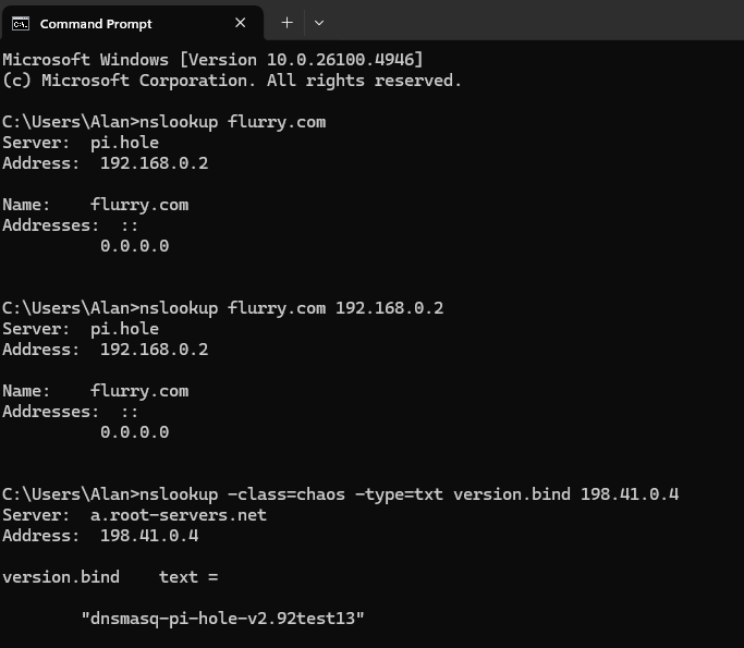

Thanks for running those commands. They reveal that something is intercepting your DNS queries and sending them to its own server instead.
The first one tells Windows to ask its DNS server to resolve flurry.com (a domain that is usually blocked by Pi-hole). Your debug log shows that Windows should be using Pi-hole. And you can see Windows thinks it is asking Pi-hole. But the answer that comes back is the IP of flurry.com.
The second one is the same test but this time forcing Windows to ask Pi-hole. Same result as the first test.
The last one tells Windows to ask for some specific details from a particular DNS server on the Internet. The result that should come back is the text "ATLAS". And Windows does indeed think it's talking to that server, but the text that comes back is "unbound 1.13.2" which is a different DNS server responding.

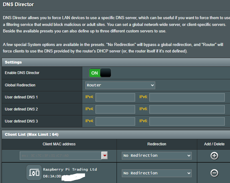

I have enabled DNS director on my Asus Router to try to force all queries through Pihole, to see if that helps

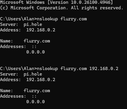

I’ve just disabled “Real Site” on my Avast Antivirus and now DNSleaktest shows my ISP as Woodnet on my Destop, not M247 anymore.
Here are those commands run again on my Desktop since disabling “Real Site” from my desktop
This looks like the cause. Windows is asking Pi-hole and the requests are now actually going to Pi-hole without Avast grabbing them. You can see the result is the blocked 0.0.0.0 and you should see the request in Pi-hole's Query Log.

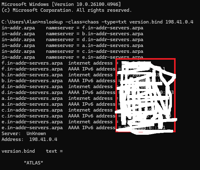

Can you try that ATLAS test too please, should work now.
How do I do the Atlas test?
As you did before: :wink:
This is what I got
Aye, that demonstrates that your router's DNS Director is working as intended, intercepting and redirecting DNS to your Pi-hole.
You should get the ATLAS response when you run that nslookup from your Pi-hole machine.
Can confirm that I get “ATLAS” when running from the pi.

Yes, that final test shows your router sent the command back to Pi-hole, which is because you enabled that router redirect setting earlier.
But I was wondering if you could disable that router redirect so it's back to the way it was, and then run that final test once again from Windows. It should now give the result ATLAS.
Once that's done, you can either leave the router redirect off and see if any other clients are affected (eg a family subscription to Avast and it's on other computers) and fix those too.
Or leave the redirect on and that will ensure no other devices can use a workaround to bypass Pi-hole, such as using Google's DNS servers. But note that that is a separate situation to this one, and it's handy that your router happens to have this feature!
