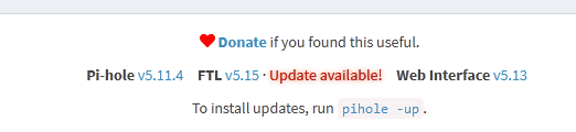

I got "[✗] Unsupported OS detected: Ubuntu 16.04" during a pihole update today
Yet I note on the web interface (admin page) that two of the 3 pihole components (all three had previously reported an update being available) appear to have been updated.
I 'tnink' i was on pihole 5.10
now on 5.11.4 and web 5.13
Only outstanding item is the FTL, which is still reporting 5.15 and requiring an update
I don't know if the FTL has been prevented from updating because of the OS unsupported error?

All i can say (without further guidance) is as per my earlier screenshot (current update status of components) and my opening post:
  • all 3 components were reported in the web UI as due for updating
  • 2 of the 3 updated (pihole and the web UI)
  • FTL is still reporting as due for updating (and i've tried to update again and it won't)
