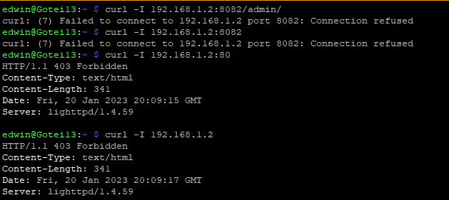

Try this:
curl -I http://192.168.1.2:8082/admin/

That is right, before the update. I just used pihole -r > reconfigure, and it let me log in with http://192.168.1.2/admin/, but the port does not change.
The port is not added automatically. You need to use http://192.168.1.2:8082/admin/.
Is there any config on the nginx to redirect to this port?
nginx cannot start because port 80 is in use. I try to use http://192.168.1.2:8082/admin/ but it does not work.

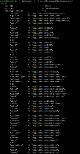

We can try to check the final lighttpd config, after reading all config files.
What is the output of lighttpd -p -f /etc/lighttpd/lighttpd.conf?
EDIT:
If you don't find the port config on the output of the command above, it means lighttpd is not reading your external.conf.
If that's the case, the solution is simple.
Is tooo long
You can paste only the part after all those file extensions.
my bad
