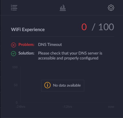

Unifi DHCP name server set to Pihole's IP address so the USG can hand out the Pihole's DNS. This does work, however, on VLANs, the clients connected get "DNS Timeouts" several times per minute.
Here's the setup:
Unifi Controller (USG) on latest firmware with 1 LAN and 2 VLANs (1 for IoT and the other for security cameras). Pihole with Unbound on Raspberry Pi.
Before splitting IoT devices and my security cameras off onto their own VLANs, this setup worked perfectly. Since then, the devices on the 2 VLANs constantly get "DNS Timeouts" in the Unifi Controller and the Roku on the IoT VLAN sometimes won't connect.

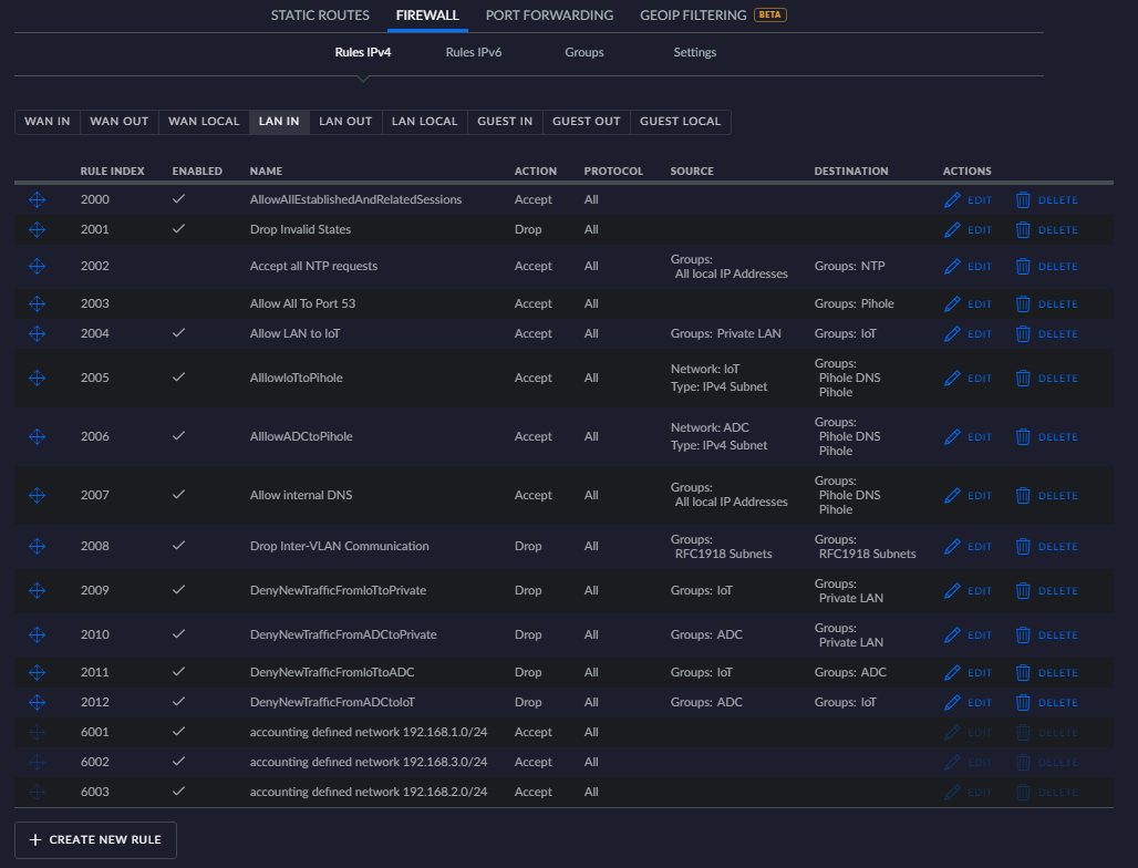

I have the Pihole's IP address in the DHCP name server field of the Unifi Controller, so the USG is successfully handing out the Pihole DNS. I have firewall rules set up in the Controller to allow the new VLANs to talk to the Pihole (192.168.1.188) and Port 53.

First off, thank you so much for the reply. It's been a frustrating journey to say the least. Yeah, I did post this same thing on the Ubiquiti forums. The only response I got so far was that my firewall rules should be in GUEST_IN instead of LAN_IN but I don't think that's right since both VLANs are Corporate and not Guest.
I also have firewall rules to allow the VLANs to talk to the Pihole (in that direction but not the other way Pihole to VLANs), but they don't seem to be working. Admittedly, I'm not 100% sure all of my firewall rules are working or are even correct. I could definitely use some eyes on them to make sure they make sense and aren't opening me up to more risk.

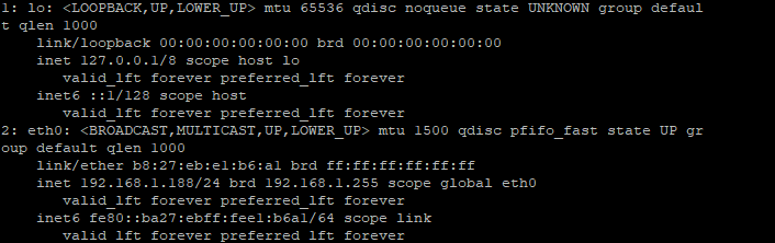

An ip addr on the Pi-hole shows this:
I think it shows my Pi-hole (192.168.1.188) on eth0.
That's showing the network interface on your Pi-hole machine. It's good it is using ethernet, as this is more reliable than WiFi, and it also means you most likely have a dedicated route to your USG (where wlan -or an intermediate switch- would mean you possibly share the connection with other clients).
