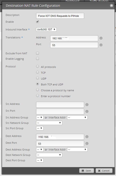

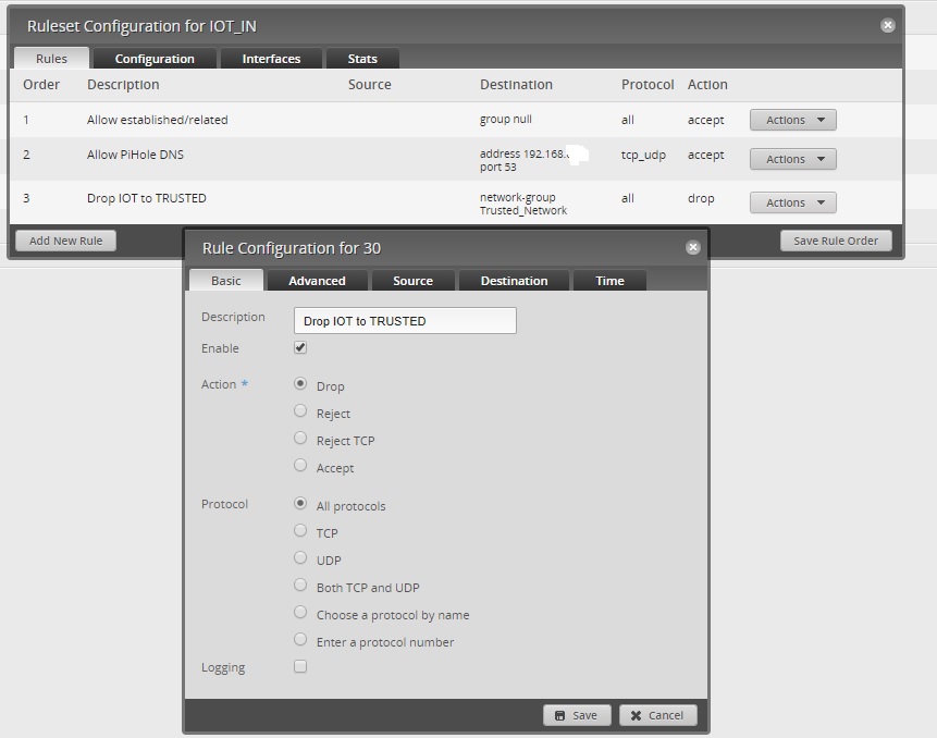

For my setup I have a destination NAT rules set for both VLANs to force traffic to my Pi-Hole.
I can ping from my Pi-Hole into any of my subnets. To do this I have a firewall (IOT_IN) rule to drop all traffic to my Trusted Networks list, but you can set that to single subnet. I use a list so I cover multiples networks.

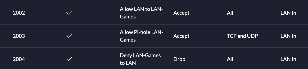

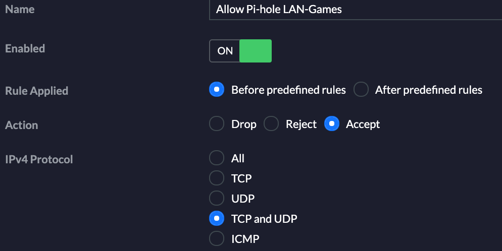

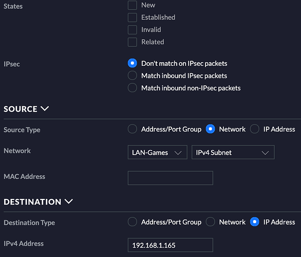

FWIW. I recently incorporated a Pi-hole into my Ubiquiti UniFi network and came across the same issue as you did with my VLAN clients not being able to use the Pi-hole successfully. I have VLANs for IoT, Games, & Media.

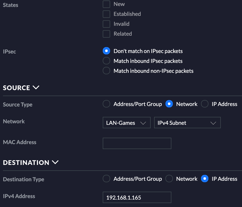

My "solution" was to create LAN-IN FW rules for each VLAN that allowed it to send DNS requests, via port 53, to VLAN1 where my Pi-hole resides. Everything works perfectly and I don't get any DNS errors reported with my USG 3P from the Controller that resides on a Cloud Key. Each VLAN has a total of three FW rules as you can see from the first image for the Games VLAN.
Hey, thanks for adding your setup! Yeah, in my initial post I added screenshots of my firewall rules. The only difference I think, is that I don't have firewall rules specifying the Pi-hole TO the VLANs. I just have it going VLANs to Pi-hole.
Just to make sure I didn't confuse you on what I did, I actually created three separate FW rules for each VLAN.
  • The first one allows all traffic from my untagged VLAN1 to the VLAN-Games. (Not sure that this one was required as I understand that the untagged VLAN1 traffic is not blocked to any tagged VLANs, by default.)
  • The second one allows only DNS (UDP & TCP, port 53) traffic from VLAN-Games to VLAN1. This is the primary rule for my game consoles on VLAN-Games to send DNS requests to the Pi-hole on VLAN1.
  • The third rule blocks all other traffic from VLAN-Games from getting access to VLAN1.

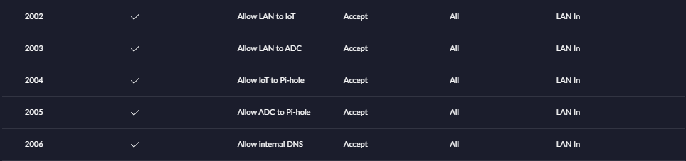

Yeah, I followed you. Here are the firewall rules I have setup:
The top two allow my Private LAN to talk to the two VLANs.
The next two allow my VLANs to talk to the Pi-hole. I have an address/port group set up for the Pi-hole address and Port 53, so the VLANs (IoT and ADC) are being allowed to talk to the Pi-hole address (192.168.1.188) and the Port (53).
I also have rules dropping traffic FROM the VLANs back to the Private LAN, so, I think our rules are very similar, if not the same, maybe except that second rule you have. I'm looking at reproducing that rule but it looks similar to the ones I already have. Is 192.168.1.165 your Pi-hole address?

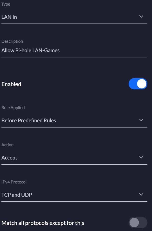

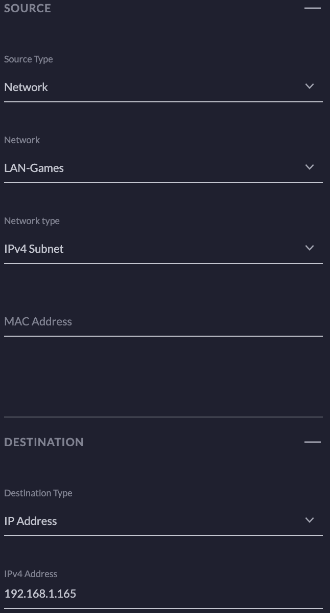

Yes, .165 is my Pi-hole. I'm using the "new" interface on the Controller Settings so things may look a bit odd.
Here's the same images with the "original" interfaceCapturFiles
Yeah, I'm nearly certain our firewall rules are the same.
