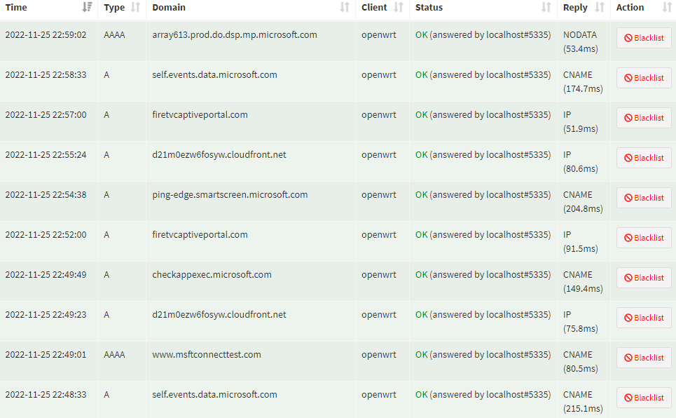

I'm getting a lot of these on Query Log:
022-11-25 21:02:01 A clients4.google.com openwrt OK (answered by localhost#5335) CNAME (96.4ms)
How can I know if it is resolved locally instead of being forwarded?
The part in brackets tells you which DNS server Pi-hole sent your query to. In this case it is localhost#5335 which is your own Unbound running on port 5335. This is correct and means your Pi-hole is sending its queries to your Unbound which is running alongside it on the same Pi.

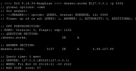

To test it now, try flushing the Unbound cache (note the dot at the end of the command) and then running the DNSSEC test from the Pi-hole Unbound setup guide.
sudo unbound-control flush_zone .
dig dnssec.works @127.0.0.1 -p 5335
If this gives NOERROR and an IP address then you're working.
Possibly but there are a lot of variables and Unbound builds up its cache along the way. See if the SERVFAIL issue is resolved.
Sorry. I wish I could do a more elaborate post. But the forum won't let me do it. I can't use quotes. New User policy
Yes. It is solved. I did what you asked me to. Flushed everything and I'm getting NOERROR.

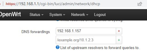

This is my setup.
I have a Openwrt. In there I set my Pi-Hole network address as DNS (192.168.1.157)
As it stands. I can't not open the pi-hole admin webpage using http:://pi.hole/admin
It can only be open using the ip address

Best thing now is to create a debug log on your Pi-hole and one of the devs will be able to take a look.
Run pihole -d and select Y when prompted to upload, then post just the debug token URL in here.
This is my debug log: https://tricorder.pi-hole.net/UCauk3Rc/
This doesn't seems to be correct. Your debug log shows your router it is using itself as DNS server (bypassing Pi-hole).

Sorry about that. I was testing yesterday and forget to remove this other DNS entry.
https://tricorder.pi-hole.net/rzKubo7V/
I still can't open http://pi.hole/admin.
Everything else is apparently working.
