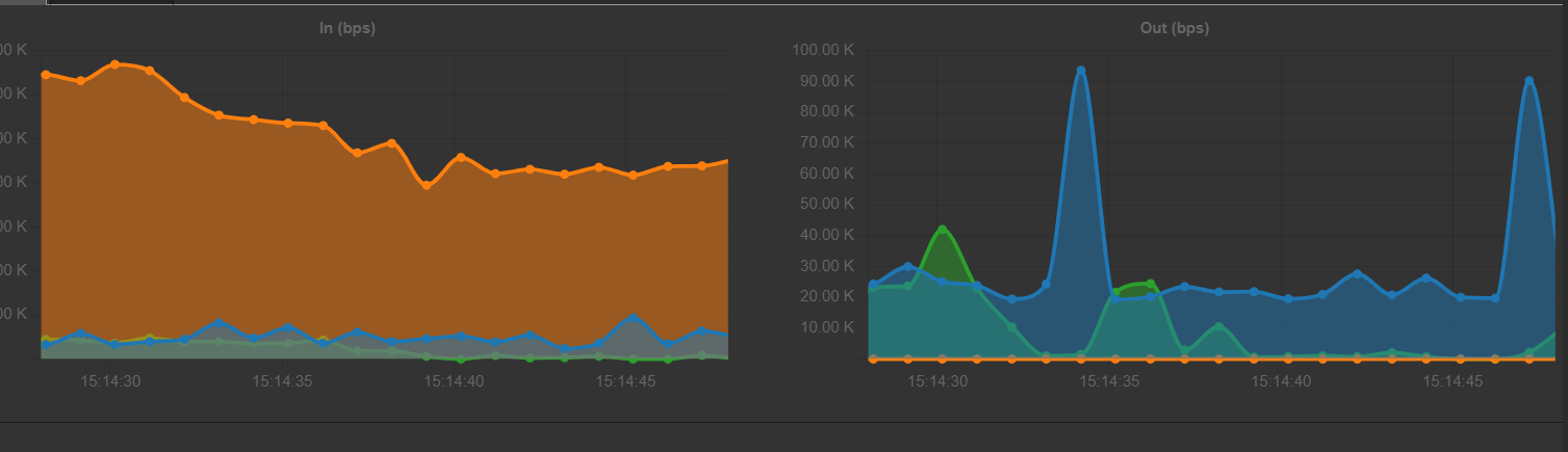

After some testing, it seems like Unbound might not be the issue after all. I changed the Pi-holes' DNS servers to 8.8.8.8 and 1.1.1.1. But as soon as I connected to WireGuard and ran a speed test, the problem happened again—my home connection broke until I restarted both the Pi-holes and OPNsense.
The more I dig into it, the more it seems like this might be an OPNsense issue. I may need to explore alternatives to WireGuard, like Tailscale, or figure out why OPNsense is acting up.
Here's a screenshot of the traffic when the issue started and during the downtime:
The left side is incoming, right side is outgoing. Orange is WAN, blue is LAN, and green is the WireGuard server. Everything looks fine, connection-wise. Just seems like DNS shits itself on my network no matter if it's unbound, or a public DNS resolver after a speed test or heavy load is needed.

DNS resolution has no impact on ISP bandwidth speed tests, as that is measuring direct communication between a test client and a speed testing server after successful DNS resolution.
The other way round, a speed test saturating your router's available download bandwidth may impact any other traffic (not just DNS) by your router being slower to accept replies.
For DNS, this may impact reply times, but not significantly.
Your trigger scenario, however, may impose additional load:
If you host a VPN server in your home network, your router has to send out all packets that a VPN client downloads, i.e. your router's upstream bandwidth becomes your VPN client's maximum download bandwith.
Consequently, running a speed test in such a scenario could saturate your router's upload bandwidth (for asymmetrical connections, long before it could saturate download bandwidth).
Depending on how your router would prioritise packets, this may significantly impact any other traffic, as packets would have to wait for the router to forward them to the Internet.
The longer that wait, the more likely a client would be to timeout, which in turn may prompt it to repeat its request, further increasing the backlog.
This would be in line with your observations:
Your unbound log as well as your dig and nslookup results show time outs.
What you've shared would not indicate unbound crashing somehow.
On the contrary, your Pi-hole and unbound log excerpts demonstrate that DNS resolution was operational all the time, but unbound was simply waiting for upstream answers.
After the speed test finishes, it may take a while before things are back to normal again. As soon as bandwidth becomes available again, all clients impacted by that wait (and possibly also your router itself) may try to work through their backlog of hanging requests by resending them - once they'd have exceeded their individual time out thresholds.
