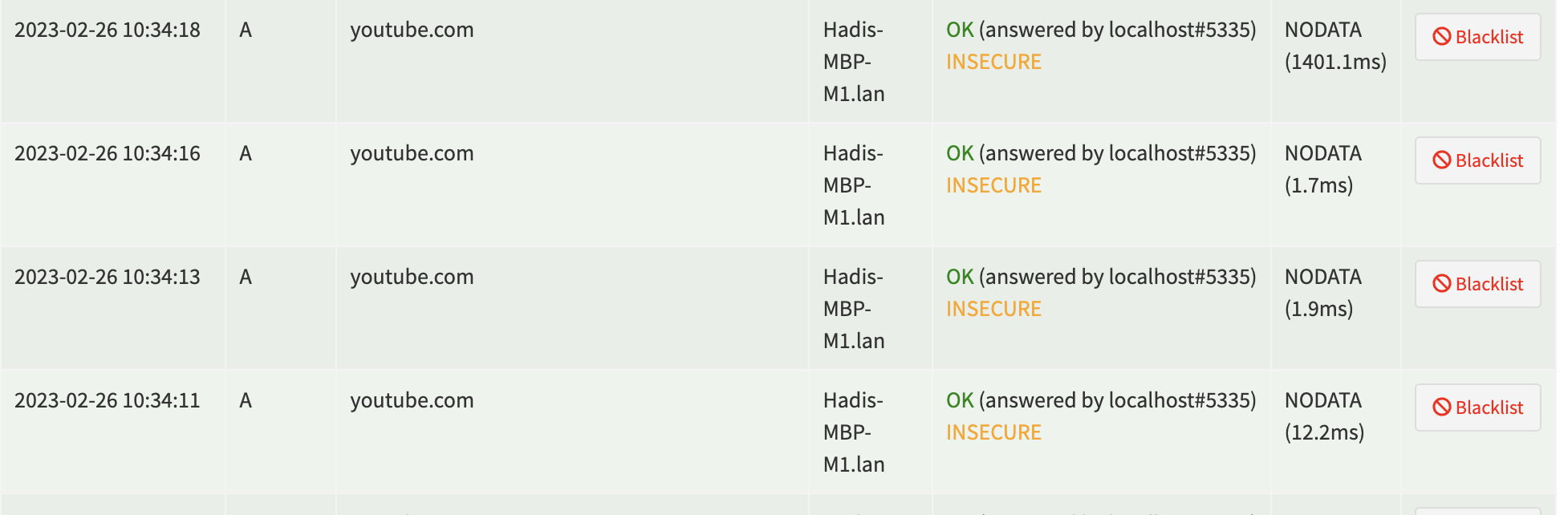

Unbound doesn't work
unbound responds with correct IP of a domain
I get SERVFAIL or incorrect IP
https://tricorder.pi-hole.net/Su5UfHBF/
I have setup Clash on my OpenWRT router. Clash does DNS hijacking to work. I setup unbound and that should avoid DNS hijacking. but doing dig dnssec.works @127.0.0.1 -p 5335 returns SERVFAIL
here is unbound log:

however, dig @127.0.0.1 -p 5335 google.com returns a wrong IP from Clash. if Unbound is working, it must return SERVFAIL for google.com as well. what is going on?
Turn off clash to eliminate one of the variables. Then see if unbound is working properly.
This query went directly to unbound. Do you have unbound configured to forward queries to an upstream resolver, or is it in recursive mode?
turning off Clash did make it work

Ow blast, while solving an Unbound issue, I observed above is the exact response if dont consider below:
So the instructions should be:
sudo tee /etc/unbound/unbound.conf.d/remote-control.conf <<< $'remote-control:\n control-enable: yes'
unbound-checkconf
sudo service unbound reload
dig +noall @127.0.0.1 -p 5335 . ns
sudo unbound-control lookup .
EDIT: To disable remote-control again:
sudo rm /etc/unbound/unbound.conf.d/remote-control.conf

btw, this is what I see on Pihole log. what does "INSECURE" means?
Thats odd.
Those "." and "XXX.root-servers.net" records should stay cached by unbound for at least 44236 seconds (approximately 12 hours):
If you get that "no delegation from cache" message intermittently within those 12 hours, it sounds as if unbound gets restarted or some other process that clears cache.
