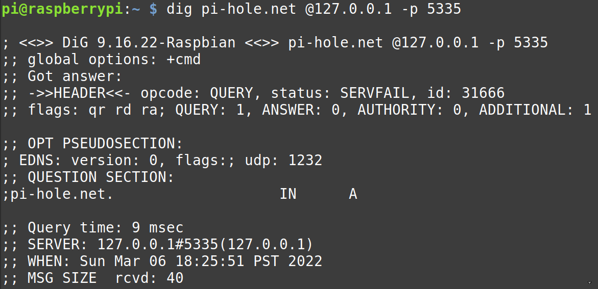

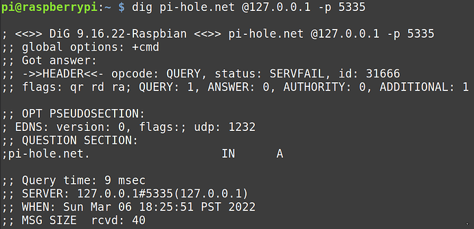

Hi, I'm a newbie to pi-hole, and I'm trying to make my local recursive DNS server via Unbound. I follow the official documentation on this (unbound - Pi-hole documentation). Supposedly, at the step where I test if the server is operational (command: dig pi-hole.net @ 127.0.0.1 -p 5335), it should return a status report of "NOERROR" with an IP address, right?

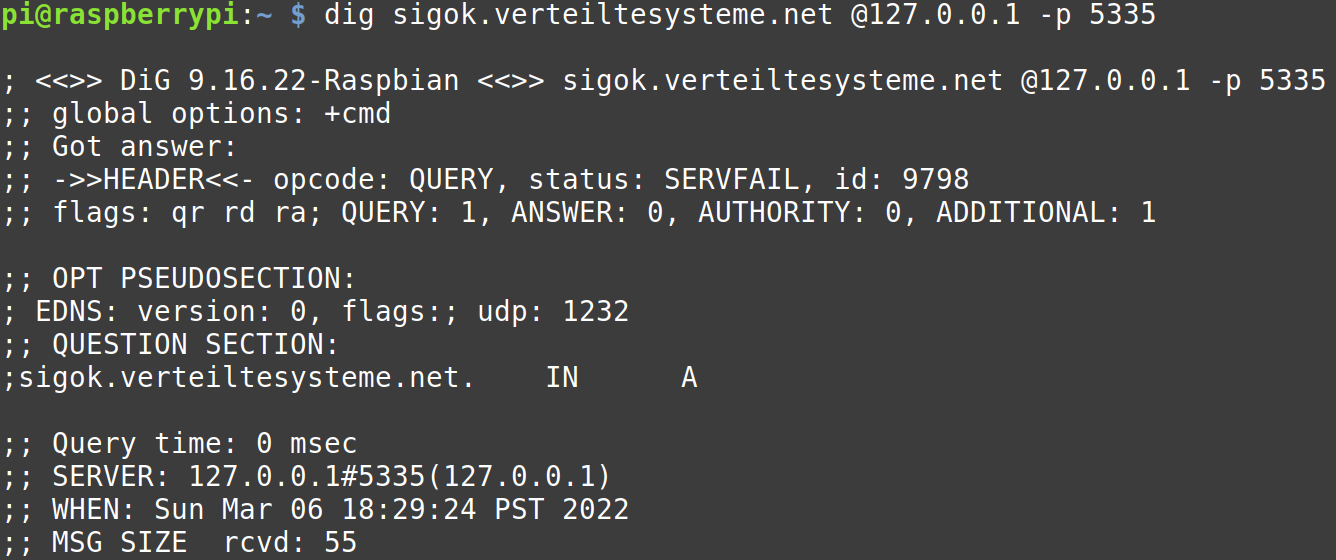

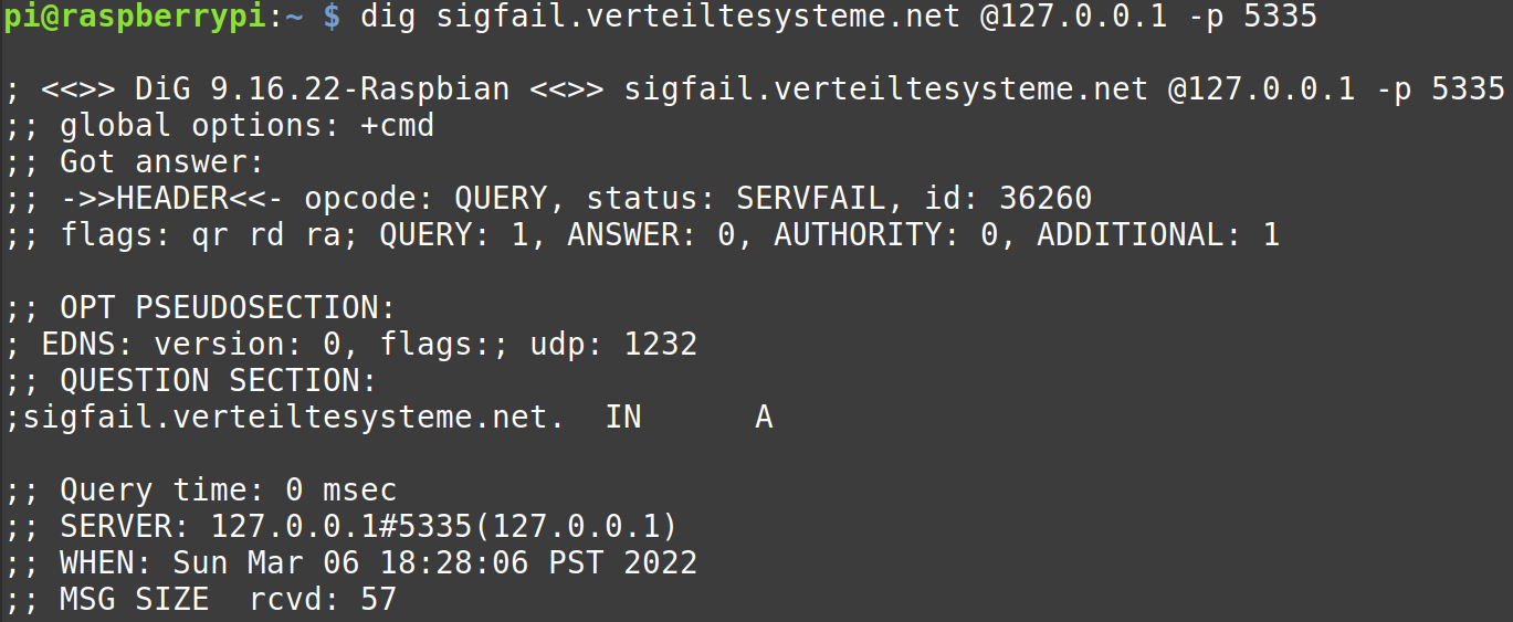

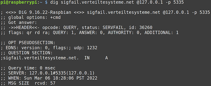

Also, in testing the DNSSEC validation (the two commands at the official documentation), the first command should give the status report of "SERVFAIL" and no IP address, and the second should give "NOERROR" with an IP address.
However, these are the results that I get:
At testing the DNSSEC validation, I get:
I am now stuck at this part. I don't know why it keeps returning the "SERVFAIL" report. I appreciate your help on this one. Thank you very much for your time.
