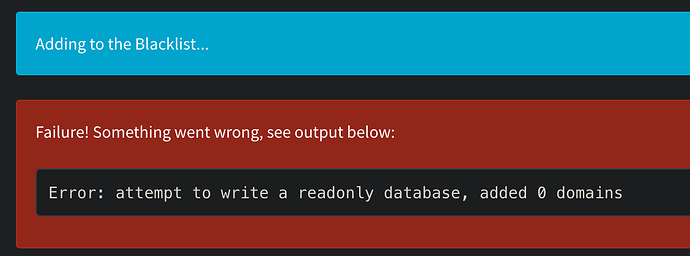

Problem with Beta 5.0:
I'm unable to add or remove entries from the white/blacklist through the admin panel. I have success editing these entries using the pihole command. When removing an entry, it looks as if it's being removed, but upon refresh, it shows again.
Whenever I use the panel to edit entries, I notice this error in the pihole-FTL.log:
[2020-01-28 19:40:46.409 3249] Warning: Invalid regex blacklist filter "^adtrack(er|ing)?[0-9]*[-.": Unmatched [, [^, [:, [., or [= (error code 7)
I tried to use the panel to remove that entry but no luck.

-- Edit --
I somehow got it removed but upon adding the fixed entry, I got this error:

What are the permissions on your database and the pihole folder? Please copy/paste the output of
ls -lh /etc | grep pihole
ls -lh /etc/pihole
drwxrwxr-x 3 pihole pihole 4.0K Mar 4 15:14 pihole

That seems okay, is the web interface user member of the group pihole?
I believe so:
To make things weirder, I can make changes to the white/blacklist using the pihole command in terminal and it works fine, but when I use the web interface, I get an error.

firestorrrm:
The permissions of the web interface are intentionally much more locked down to avoid opening security holes when other web services are hosted next to Pi-hole on the same web server so this is expected in some degree.
Had same issue here, fixed it by:
usermod -a -G pihole www-data
service pihole-FTL restart
service lighttpd restart
anon55913113:
Look in the group www-data if the user pihole is present or vise versa.
Present in both but still no luck
Harm_Veenstra:
Did this and still no luck.
Did ‘usermod -a -G www-data pihole’ before that and didn’t work, perhaps you need both and restart the services?
Yup, did usermod then restarted pihole-FTL & nginx (using nginx)

I went through each directory for pihole and looked at the ownership/group of each file. Here's what I found:
The ownership for /var/www/html/admin/scripts was www-data:
drwxr-xr-x 4 www-data www-data 4096 Mar 7 14:09 scripts
Within the scripts directory, the ownership for /var/www/html/admin/scripts/pi-hole was also www-data:
drwxr-xr-x 4 www-data www-data 4096 Mar 7 14:09 pi-hole
As well as the directories inside js and php
drwxr-xr-x 2 www-data www-data 4096 Mar 8 15:58 js
drwxr-xr-x 2 www-data www-data 4096 Mar 8 15:58 php
However, the files within, had root as the owner/group. Here's a snip from the php folder:
-rw-r--r-- 1 root root 2549 Mar 8 15:58 add.php
-rw-r--r-- 1 root root 431 Mar 8 15:58 api_token.php
-rw-r--r-- 1 root root 5033 Mar 8 15:58 auth.php
-rw-r--r-- 1 root root 3881 Mar 8 15:58 customdns.php
-rw-r--r-- 1 root root 7621 Mar 8 15:58 database.php
-rw-r--r-- 1 root root 728 Mar 7 22:55 debug.php
-rw-r--r-- 1 root root 3855 Mar 8 15:58 footer.php
-rw-r--r-- 1 root root 1382 Mar 8 15:58 FTL.php
-rw-r--r-- 1 root root 1516 Mar 8 15:58 func.php
-rw-r--r-- 1 root root 1788 Mar 8 15:58 gravity.php
-rw-r--r-- 1 root root 1225 Mar 7 22:55 gravity.sh.php
-rw-r--r-- 1 root root 27659 Mar 8 15:58 groups.php
-rw-r--r-- 1 root root 32099 Mar 8 15:58 header.php
-rw-r--r-- 1 root root 3560 Mar 8 15:58 loginpage.php
-rw-r--r-- 1 root root 3208 Mar 7 22:55 password.php
-rw-r--r-- 1 root root 1740 Mar 7 22:55 queryads.php
-rw-r--r-- 1 root root 20507 Mar 8 15:58 savesettings.php
-rw-r--r-- 1 root root 1285 Mar 7 22:55 tailLog.php
-rw-r--r-- 1 root root 14484 Mar 8 15:58 teleporter.php
-rw-r--r-- 1 root root 2535 Mar 7 22:55 update_checker.php
Once I changed the ownership of these files to www-data, I was able to restore the functionality of editing the white/blacklists in the admin panel.

Worked for me with some slight alterations (ubuntu install), I included the above chown option for the web pages.
chown www-data:www-data -R /var/www/html/admin/
usermod -aG pihole www-data
systemctl restart apache2
