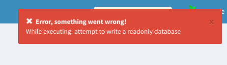

Error message: "Attempt to write a readonly database"
Installation went fine, and everything seems to work properly, except for the Group Management area. If I try to change anything relating to a group or client or domain, I get a message: "Error, something went wrong! While executing: attempt to write a readonly database."
To make sure this wasn't related to something I'd done to my install (I run an Nginx reverse proxy in front of it), I uninstalled Pihole completely, then reinstalled the latest stable version, then upgraded to the beta over the top. It still does it. Any ideas?

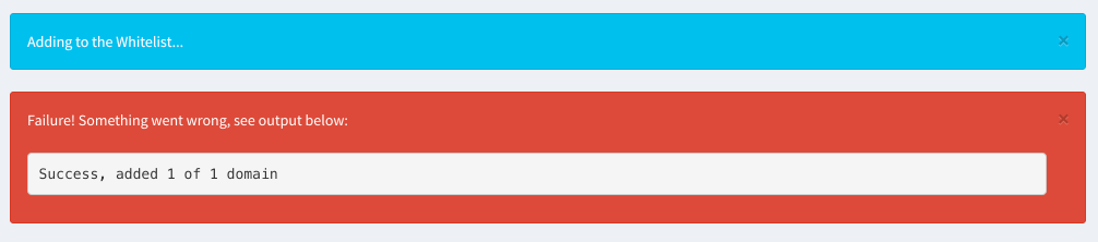

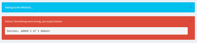

I can also add domains to the whitelist. But . . . for some reason, the whitelist doesn't show me the items that are on it, and even when it works, it gives me "Failure!" messages. If I try to add a new item that I know is not on the list, it says the following:

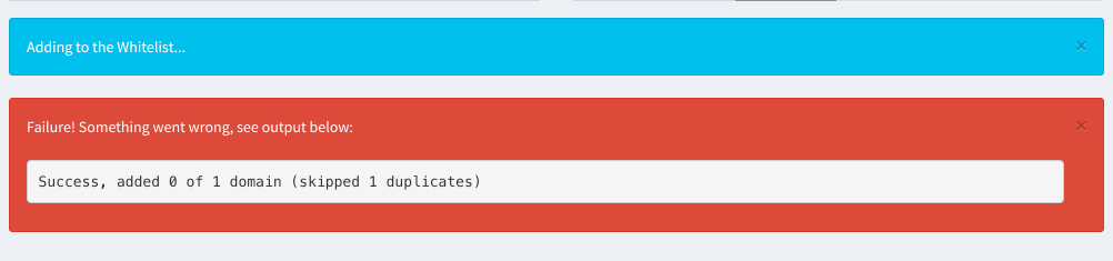

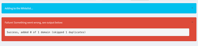

If I try to add an entry that I know is already on there, it gives me an error:

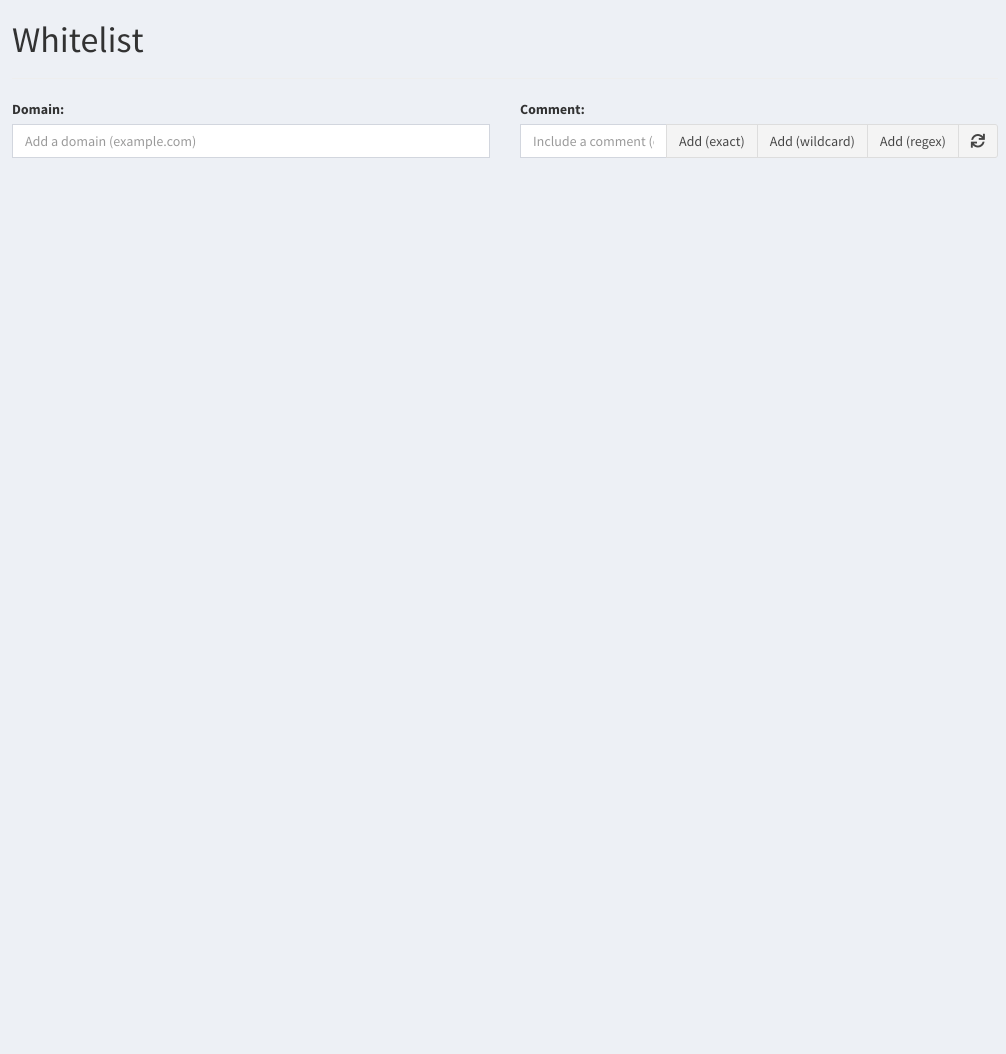

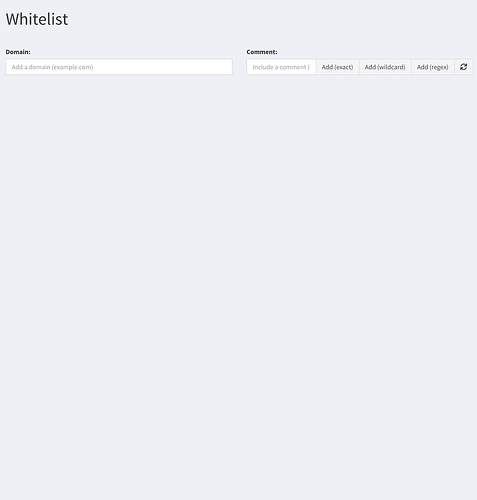

In all cases, it doesn't show me what is on the list. The page looks like this:
Any ideas as to why? Thanks!
UPDATE: I cleared the cache in my browser, and everything showed up as expected. Thanks!
UPDATE 2: I said in an earlier post that the entries from my previous install had not migrated. This was incorrect. They just weren't showing up until this issue was resolved.
