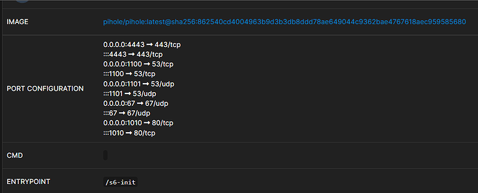

From your screenshot on Github,
You have port 53 used on the host device.
Edit:
- "1100:53/tcp"
- "1101:53/udp"
You can't do that unless you have a way to make every client use port 1100.
