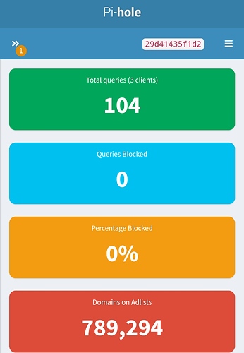

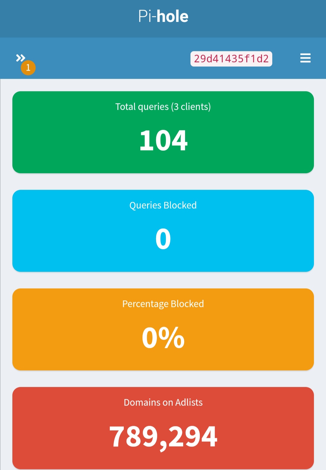

Unable to connect
I was able to set up UDP 53 running
But why is it not blocking ads.
Ad blocking is enabled
2022-10-10
11:17:36 LOAD Long-term load (15min avg) larger than number of processors: 4.9 > 4
This may slow down DNS resolution and can cause bottlenecks.
Showing in the diagnostic section
