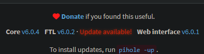

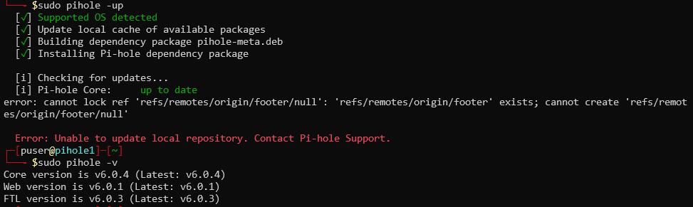

Thanks again for resolving my prior issue. On my pihole1 appliance i'm now encountering a new, unexplained error message while trying to run through the update process. No issues with pihole2, it updated just fine again this morning.
  [✓] Supported OS detected
  [✓] Building dependency package pihole-meta.deb
  [✓] Installing Pi-hole dependency package
  [i] Checking for updates...
  [i] Pi-hole Core:     up to date

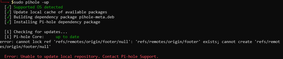

error: cannot lock ref 'refs/remotes/origin/footer/null': 'refs/remotes/origin/footer' exists; cannot create 'refs/remotes/origin/footer/null'
  Error: Unable to update local repository. Contact Pi-hole Support.

Your debug log says you are running master branch, but your screenshot suggests you are running a different branch for the Web component: footer/null
Try to fix it running pihole checkout web master, then try to update again.

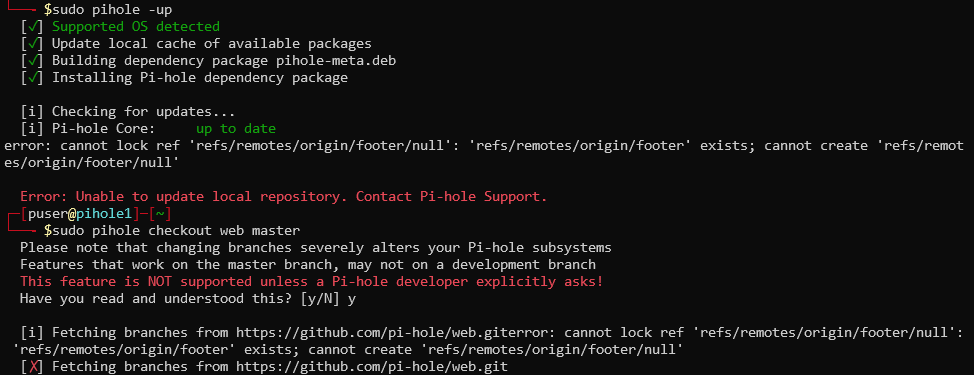

Sadly, still blocked with same / similar error message.
Please note that changing branches severely alters your Pi-hole subsystems
  Features that work on the master branch, may not on a development branch
  This feature is NOT supported unless a Pi-hole developer explicitly asks!
  Have you read and understood this? [y/N] y
  [i] Fetching branches from https://github.com/pi-hole/web.giterror: cannot lock ref 'refs/remotes/origin/footer/null': 'refs/remotes/origin/footer' exists; cannot create 'refs/remotes/origin/footer/null'
  [✗] Fetching branches from https://github.com/pi-hole/web.git
