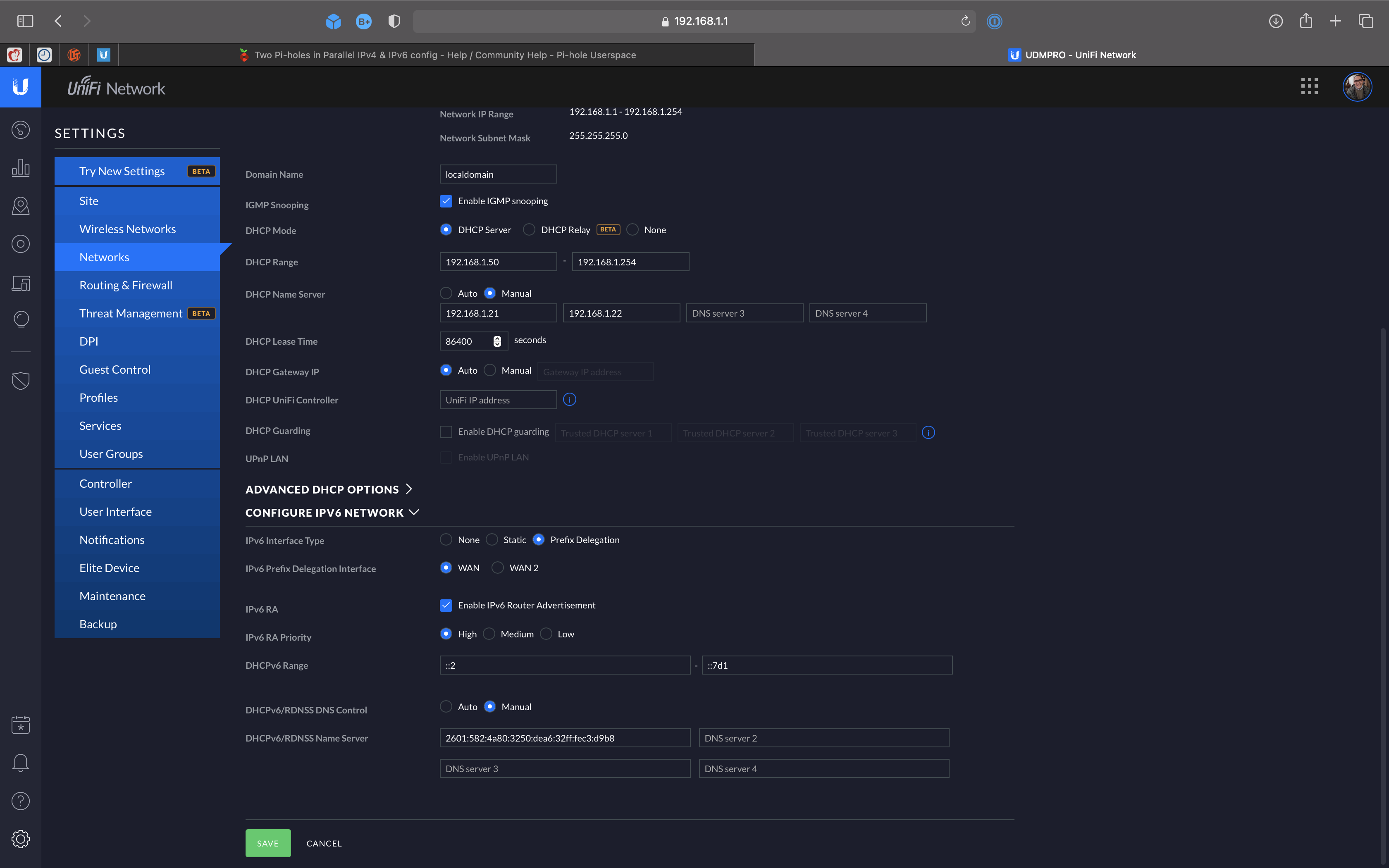

I have my router pointing the DNS server to both IPv4 addresses and to 1 IPv6 address.
As you can see, the IPv6 addresses are the same. Is there a way to make them different? I'm guessing this is not playing great within my network. Unless someone knows something, and might be able to explain to me that this shouldn't be an issue.

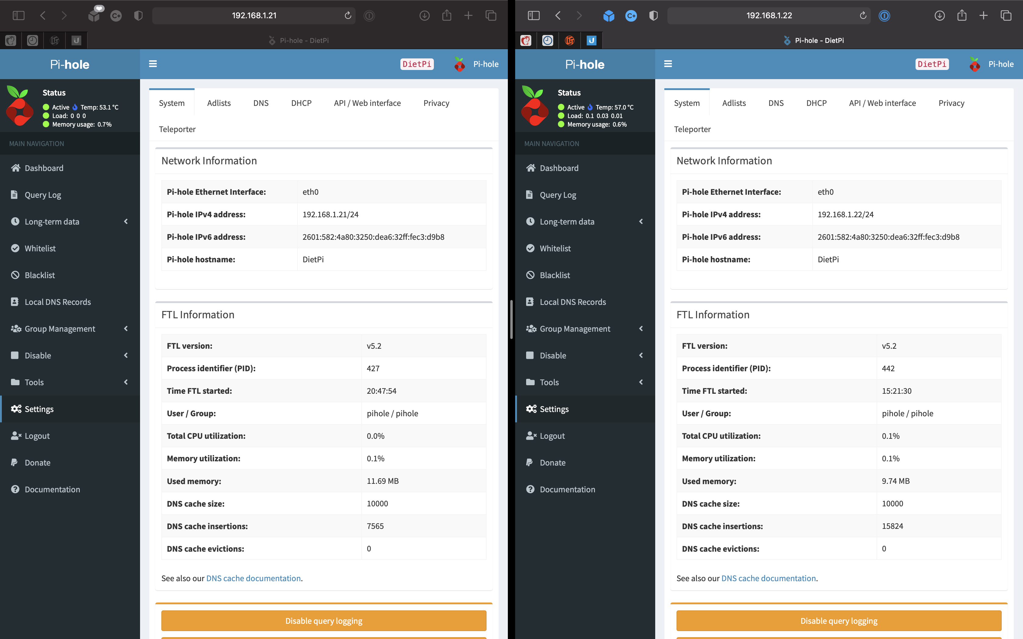

I uploaded a screenshot of both RPi Pi-hole settings.
Raspberry Pi-1:

Here is a copy of my network settings:
The commands have confirmed your RPis to have different public IPv6 addresses, which you could configure in your router.
