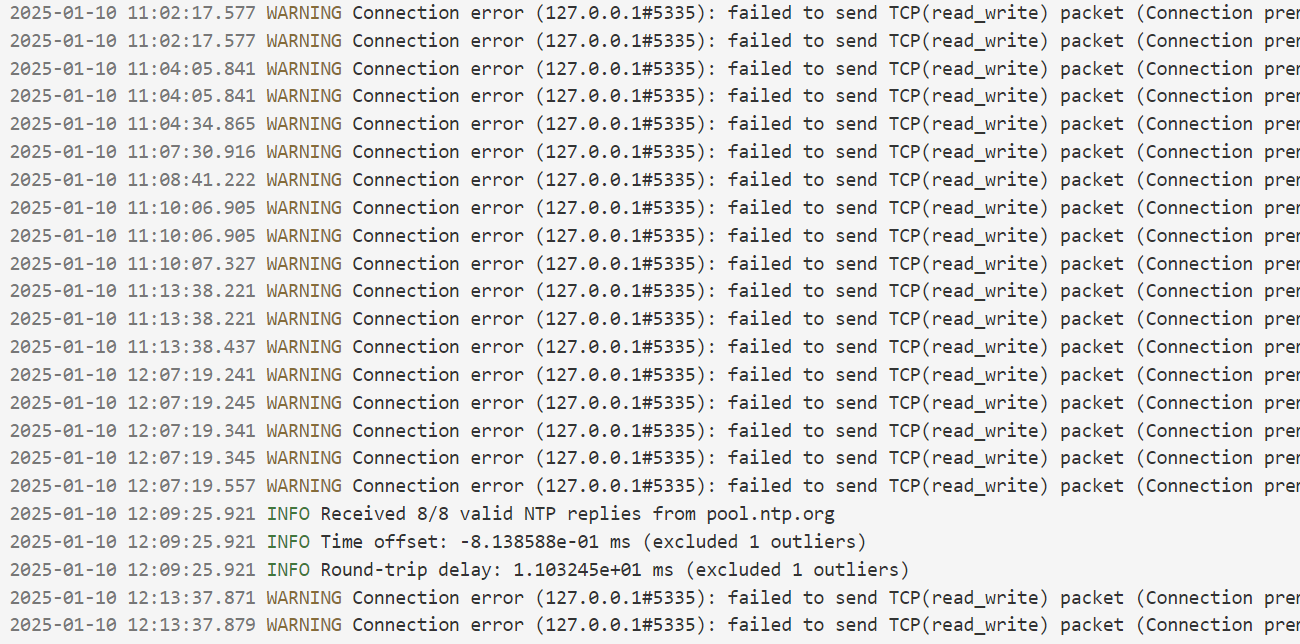

I have again (shared previously) started to see lots of "failed to send TCP(read_write) packet (Connection prematurely closed by remote server)".
I am having two instances of Pi-hole on my LAN, on for my wired LAN and one for my wireless LAN, each on different Port and IP address.
Only the Pi-hole that serves the wired LAN shows the message. The wired LAN also got the less clients and activities.
Unbound is running on both Pi-hole instances.
On each I use "Bind only to interface".
FTL log from today morning.
seh2000 FTL-log 05Jan2024.txt (28.8 KB)

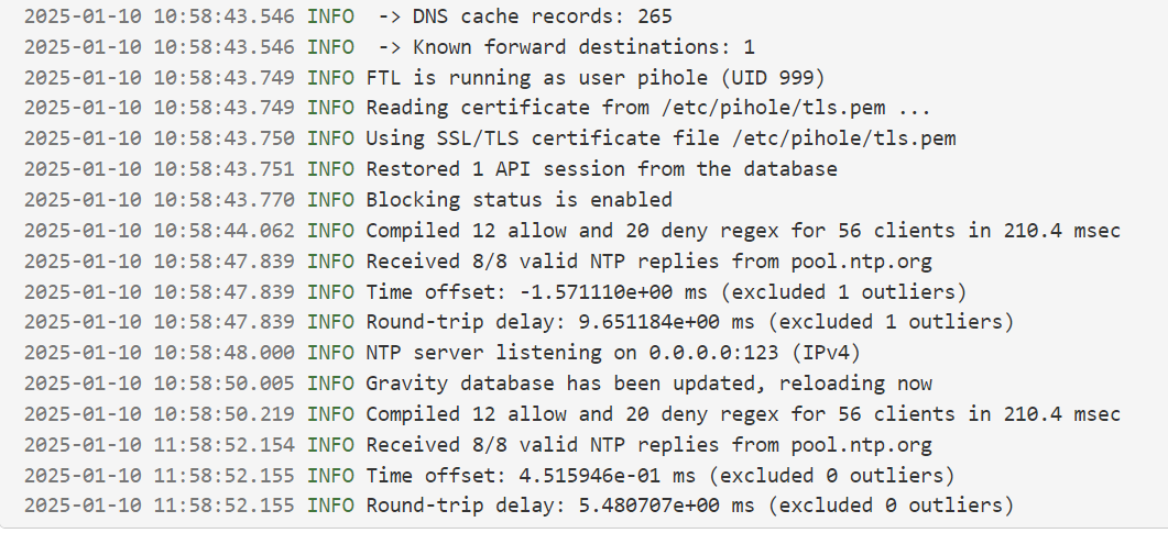

Interesting is the "issue" appears to happen around a NTP check, this could for sure be a coincidence, but wanted to mention.
Pi A
2025-01-21 21:19:03.824 INFO Time offset: 1.394719e+00 ms (excluded 0 outliers)
2025-01-21 21:19:03.824 INFO Round-trip delay: 5.113423e+00 ms (excluded 0 outliers)
2025-01-21 21:55:39.067 WARNING Connection error (127.0.0.1#5335): failed to send TCP(read_write) packet (Connection prematurely closed by remote server)
2025-01-21 22:12:09.129 WARNING Connection error (127.0.0.1#5335): failed to send TCP(read_write) packet (Connection prematurely closed by remote server)
2025-01-21 23:36:04.536 INFO Received 8/8 valid NTP replies from pool.ntp.org
Pi B
2025-01-22 05:37:23.126 INFO Round-trip delay: 9.762764e+00 ms (excluded 1 outliers)
2025-01-22 06:28:07.174 WARNING Connection error (127.0.0.1#5335): failed to send TCP(read_write) packet (Connection prematurely closed by remote server)
2025-01-22 06:37:24.189 INFO Received 8/8 valid NTP replies from pool.ntp.org
I don't really see any relation to the NTP syncs here, they at least ten minutes away in the snippets you posted.

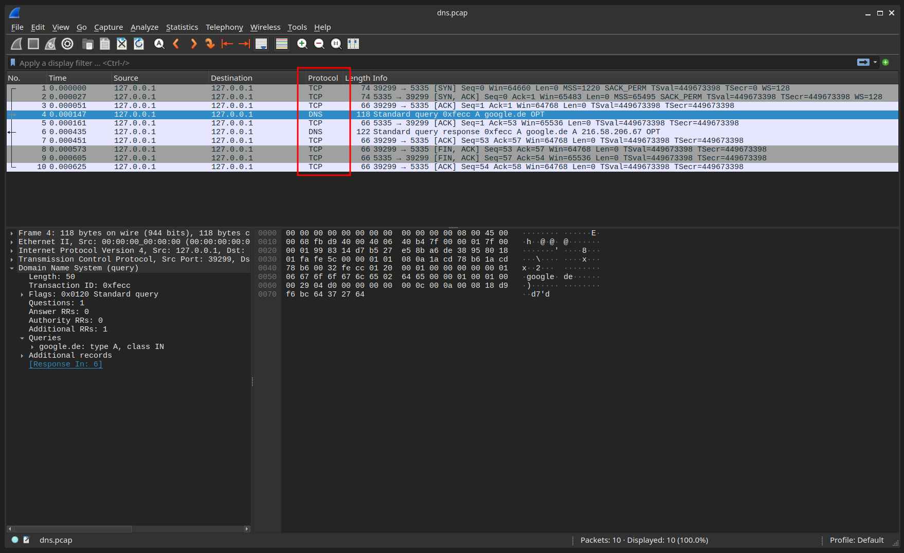

Sorry for the delay, you can use what you proposed, I'd probably have used
sudo tcpdump -i lo -w /tmp/dns.pcap -n -p tcp port 5335
to capture TCP traffic to/from port 5335 on interface lo and save it into /tmp/dns.pcap but the difference is small. You can thereafter use WireShark to open this PCAP for easy inspection.
Hint

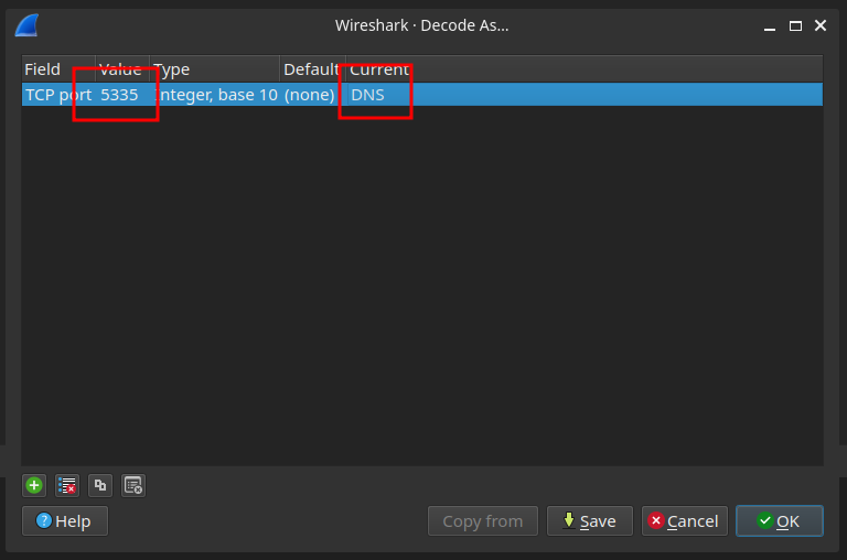

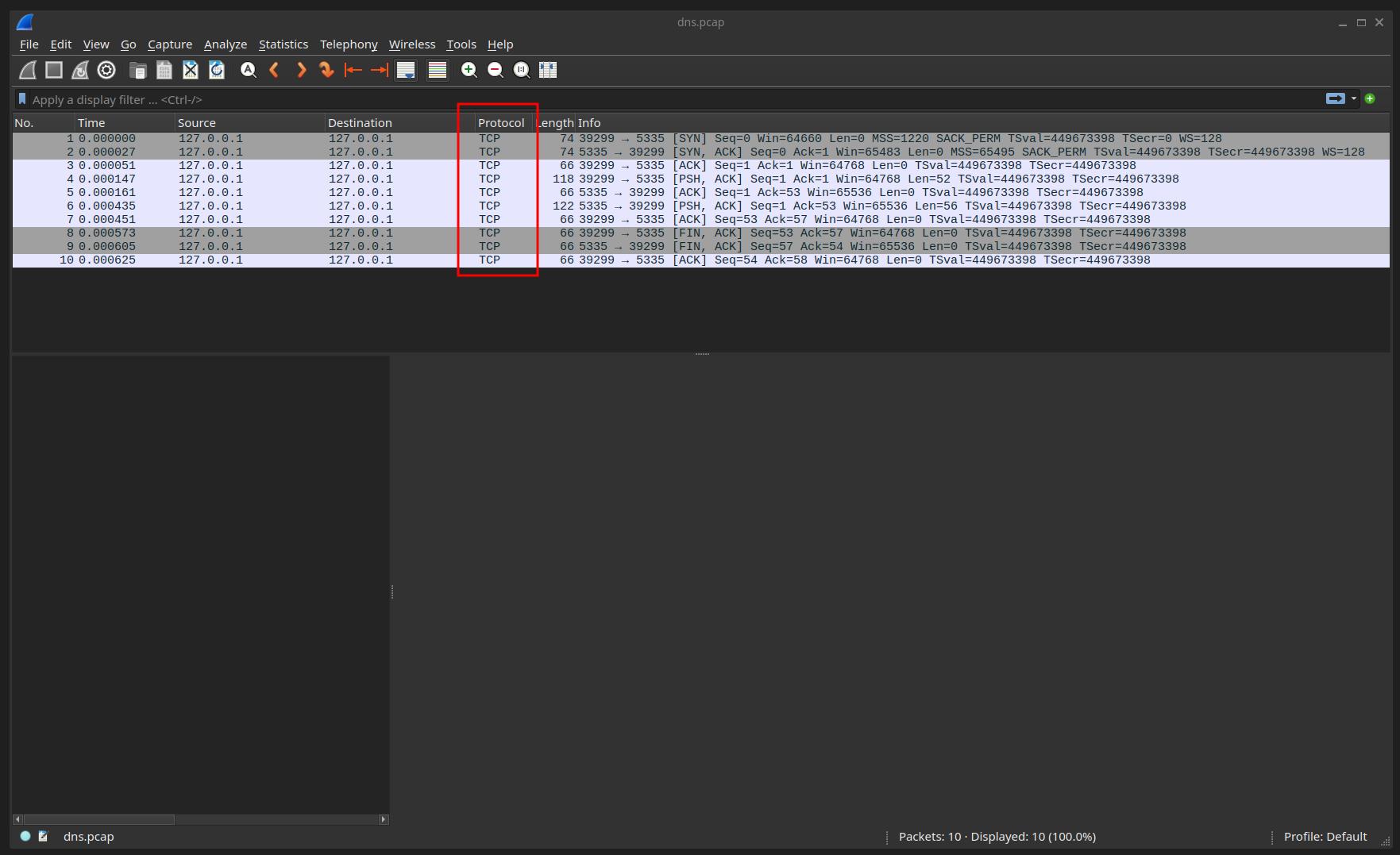

In case Wireshark shows only raw TCP traffic (as in: it does not automatically decode as DNS), you would see only TCP as protocol but never DNS, something like:
This can happen because port 5335 is not associated to DNS by default (e.g., 5353 would be). You can achieve this by navigating through the menu Analyse -> Decode As... and assigning DNS to TCP port 5335 manually like
Thereafter, Wireshark can correctly decode your packet recordings:
The remaining TCP stuff is protocol-inherent overhead and nothing to worry about. It may still be interesting to see around the location where you see the warning as a prematurely closed connection can also be because the ACKs did not arrive or other errors indicating the upstream closed the socket.

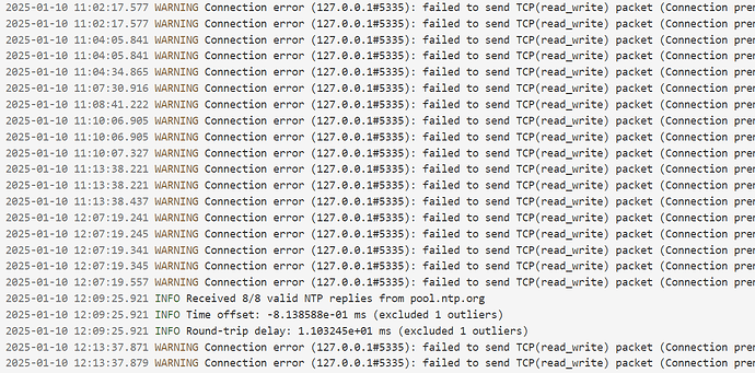

Hi again.
I got a couple of incidents.
Unfortunately I am not sure if I captured them correctly.
Attached the FTL.log and the dns.pcap files.
Incidents are at in the shFTL.log:
19:00:34.889
19:09:02.394
19:37:32.562
19:42:41.765
19:42:41.864
I searched the pcap file for something around the above times., but guess of ,my lack of knowledge I failed to find anything.
Steen
With the FTL log alone (I did not even need the PCAP file in the end), I was able to reproduce what is going on: In all cases in your log, the flow is the same:
  1. A client requests a domain via TCP, Pi-hole forks a dedicated worker to serve this request
  2. Pi-hole immediately replies with the "cache optimizer" to reduce latency. However, in all cases the queries where actually outdated so Pi-hole generated internal queries to "refresh" and update the possibly outdated cache records.
  3. At the same time, the clients closed their TCP connection because they are done
  4. The TCP worker is terminating while it is requesting the refreshment. This causes the warning.
Thank your much for your continued assistance! We will now discuss with the dnsmasq maintainers how to resolve this in the best way.
