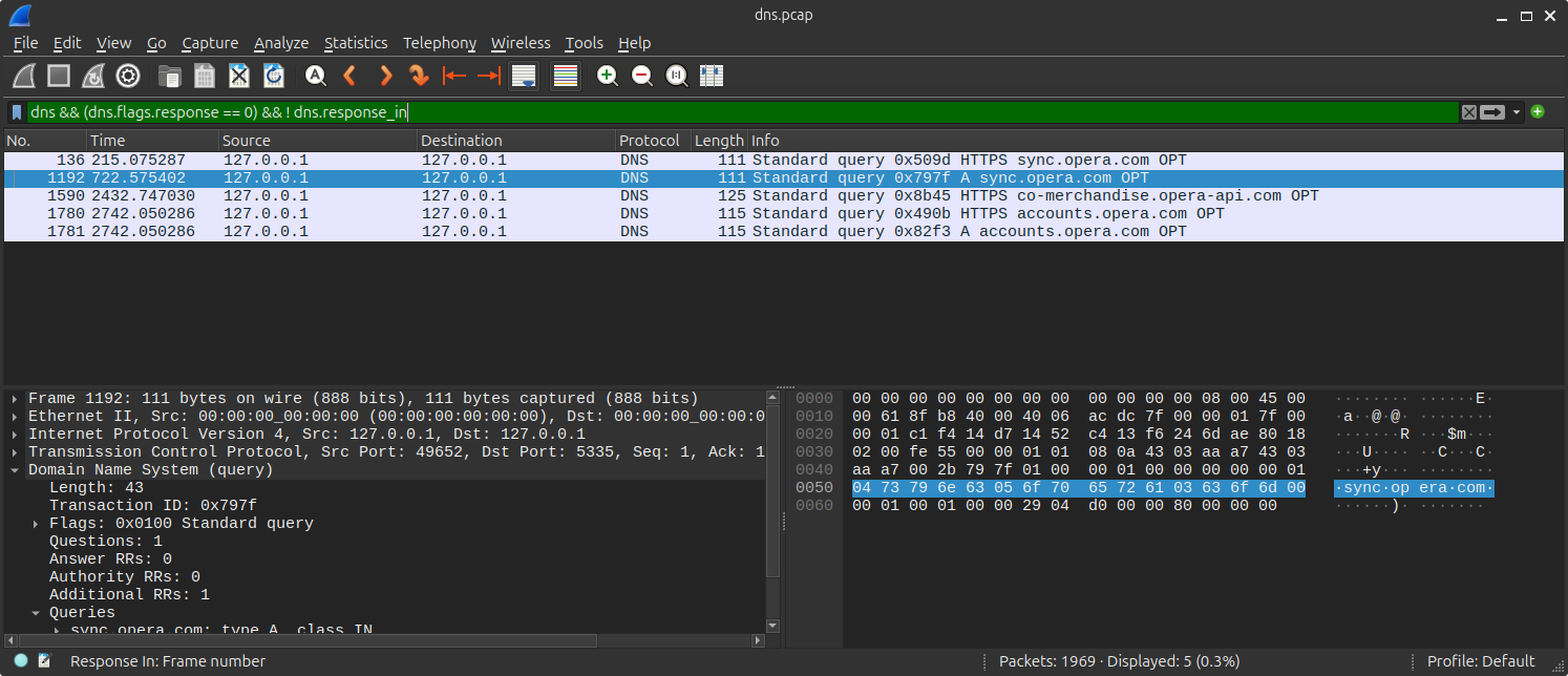

dns && (dns.flags.response == 0) && ! dns.response_in
I reduced the shown packages to those who were sent to unbound and were never replied to. Not many, but certainly there is an issue on unbound's side here:
This matches the related log file perfectly because it also has the Connection prematurely closed by remote server message for exactly these five queries. So the problem is really not with Pi-hole / dnsmasq but with unbound and the warning is actually correct.
I can confirm that in each case, unbound terminated/closed the connection. In all working cases, however, dnsmasq closed the connection on its side once the reply was received.
