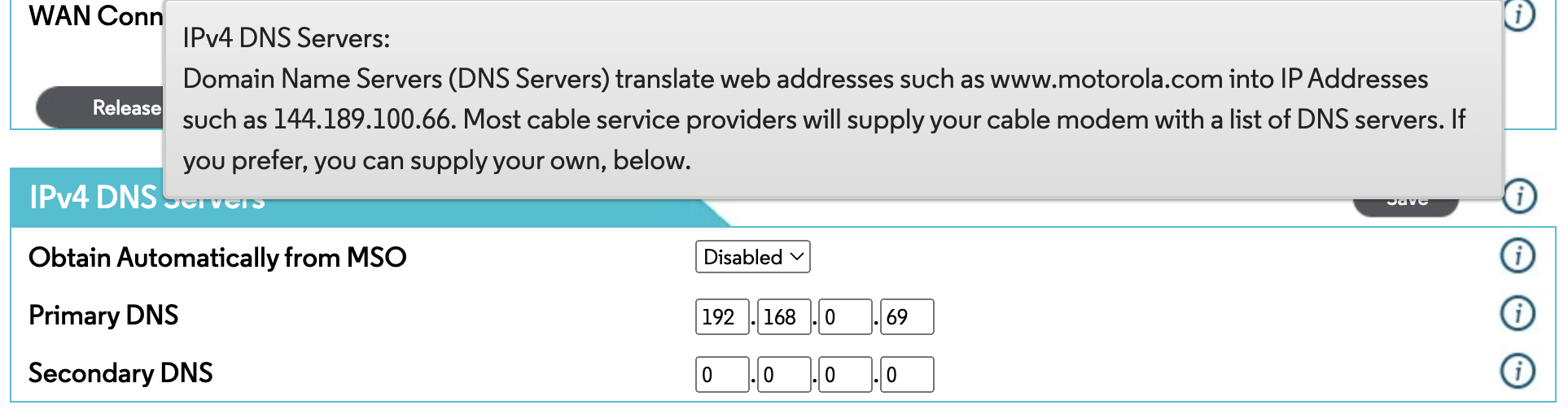

Running pihole on a Raspberry Pi 3b+. DHCP is my router, a Motorola MG7550, which has the primary DNS set to my pihole (192.168.0.69), secondary DNS 0.0.0.0, and ipv6 disabled.

Yeah, the 75.75.75.75 and 75.75.76.76 are definitely Comcast, and shouldn't be there. The DNS for the router is set under Advanced > Status > Connection > IPv4 DNS Servers (screenshot below with Help text). The DHCP settings really just has whether or not the DHCP server is activated (yes), the local address pool + lease time, then clients and setting static IPs.

I was hoping to avoid going that extra step by finding out how / why my router is inserting some other DNS in, or finding some mistake I've made, but maybe I don't have a choice. I definitely want to avoid manually configuring each device, as I would like my partner's devices and my Android streaming box to easily utilize the pi-hole as well.
