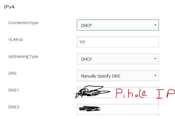

It appears that all DNS queries are coming from the router currently. I set the router to sue Pi-Hole for DNS but am unsure as to why only (was 2 now 3) devices that I didn't do anything with are using Pi-Hole and not others.
This is how I have pointed my router to PiHole for DNS
It would be better if you showed us the IPs in both DNS1 and DNS2. It's a private range, so you aren't letting out any secrets here.
192.168.1.39 for both DNS 1 and DNS 2 which is the PiHole

This may just be the way your router behaves. Set Pi-hole as your DHCP following the notes in the previous link and see if this resolves the problem.

That might be an indicator that you have set Pihole as your router's DNS server on WAN.
Did you also specify to distribute pihole's IP as DNS via DHCP on LAN? If you did so just currently you have to diconnect your clients once from the router to get a new DHCP lease with the updated DNS information.
