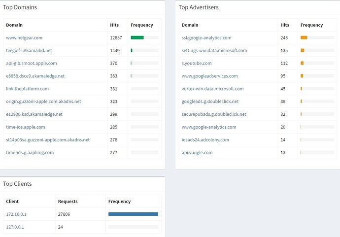

hello, i was looking at my pi-hole dashboard and i saw that www.netgear.com is my top domain at over 11000. is this normal? what does this mean

oh thats not normal: any unknown device cannot cache the resolved domain.
You can look for the ip address wich requested the domain. Then look to wich device it belongs and tell us maybe the device model.
It isn't necessary dangerous but a bit annoying
Its normal for first time Pi-Hole users to be suspicious about anything in the logs :wink:
Probably it is your router or WiFi-AP calling home checking amongst others for firmware updates.

Here is a useful one for when your logs have grown too large to be displayed on the web GUI:
grep -e '^.*query.*www.netgear.com.*$' /var/log/pihole.log | awk '{print $8}' | sort | uniq -c | sort -n -r | head -10
But I can already see Top client being your router as suspected 172.16.0.1
Try removing Pi-Hole to be the upstream DNS resolver for your router.
Eg. default your routers upstream DNS so it receives default DNS servers from your ISP.
Owh and you can see if worked if you keep an eye (tail) on the logs:
tailf /var/log/pihole.log | grep -e '^.*query.*www.netgear.com.*$'

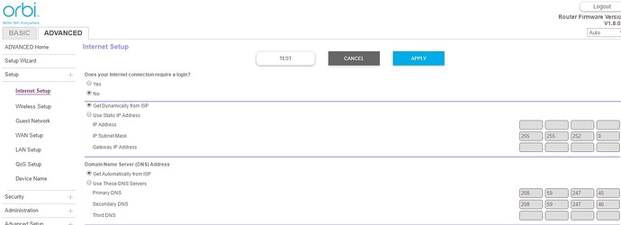

sorry if i am not understanding you, i looked out my router and on this page here i had manually entered in my pi-hole dns, since you replied i let me ip configure it:
is this what you meant?

Thats correct.
If you check the Installation part on the main page, it only mentions that you have to change the DNS server setting on the DHCP service page of the router:
And if the router doesnt allow, you could use the DHCP service that comes with Pi-Hole (after you disabled the DHCP service on the router).
Yes, this is probably the case...
https://pi-hole.net/2017/02/22/what-really-happens-on-your-network-find-out-with-pi-hole/
If you happen to change the DNS server under WAN or Internet settings in the router and your then your router will show as the only client. When you set the DNS server under DHCP options, you are telling each of your individual clients to use Pi-hole as their DNS and should see entries for each device using Pi-hole.

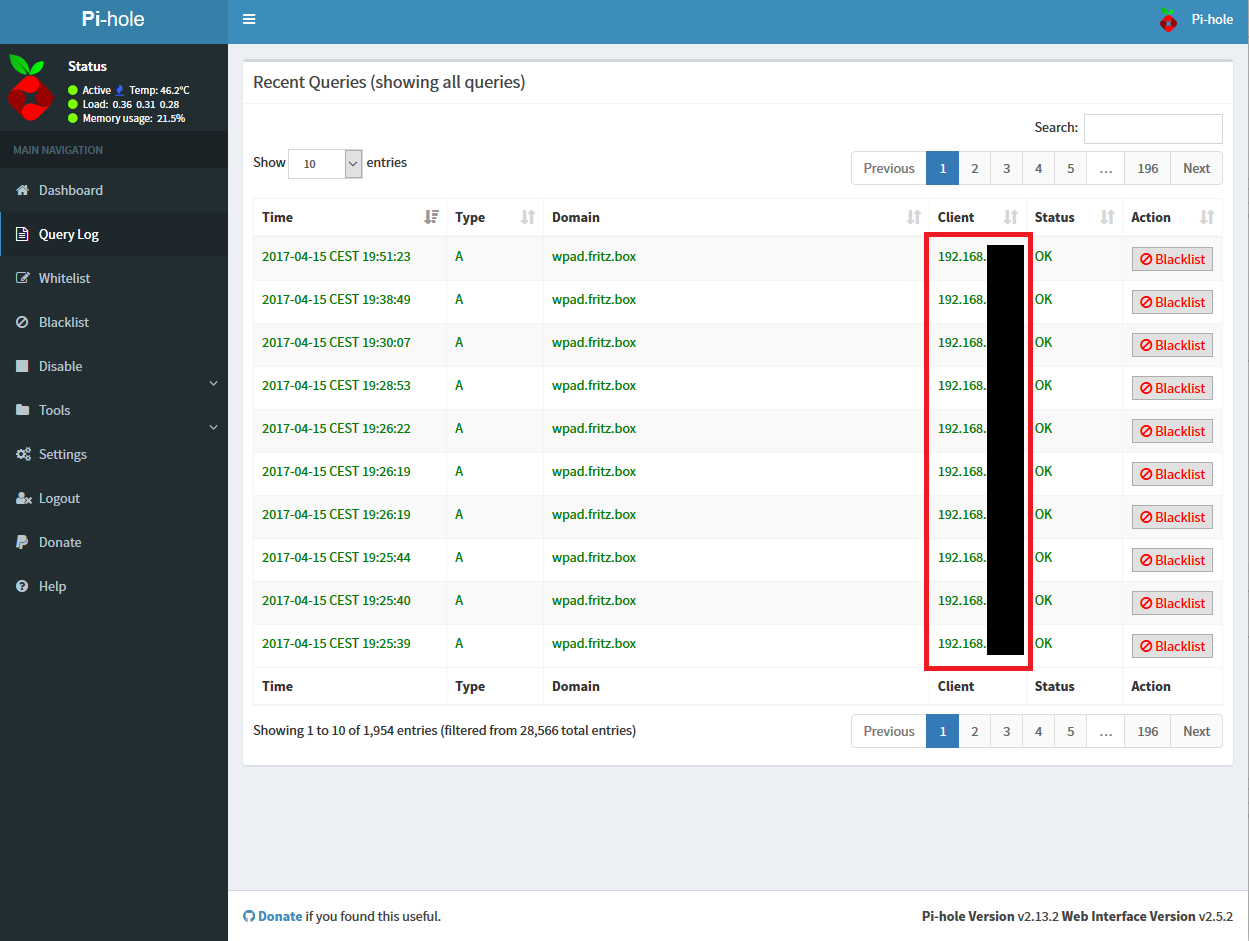

@ Master
I was looking at your screenshot with all the requests to wpad.fritz.box.
I'm using pfsense as a router/firewall, and it's mandatory to define a domain (the default is localdomain, but you obviously used fritz.box). On my older router, a domain wasn't mandatory, so I never had these queries.
As soon as windows machines (and possibly others) receive a domain setting via DHCP, this behavior starts. You can find your domain setting, using ipconfig /all and look at the setting Connection-specific DNS Suffix
It would supprise me if yours wasn't reporting fritz.box

Oh thank you for the answer,
I just created the Screenshot to help LilSnoop40.
I don't know what's "wpad" in my Network and it just popped up yesterday. Yeah my DNS-Suffix is fritz.box, defined by my FRITZ!Box, but i didn't activate "never forward non-FQDNs" and "never forward reverse lookups for private IP ranges" because my FRITZ!Box is the second DNS-Server (There is the DHCP and i don't want to set up every device like here). And also i don't know, if the domain "wpad" could be resolved.
I really don't know what you mean with the solution wpad.dat etc. I had no timeout errors :slight_smile:
Today the entry disappeared. But thanks for your efforts
