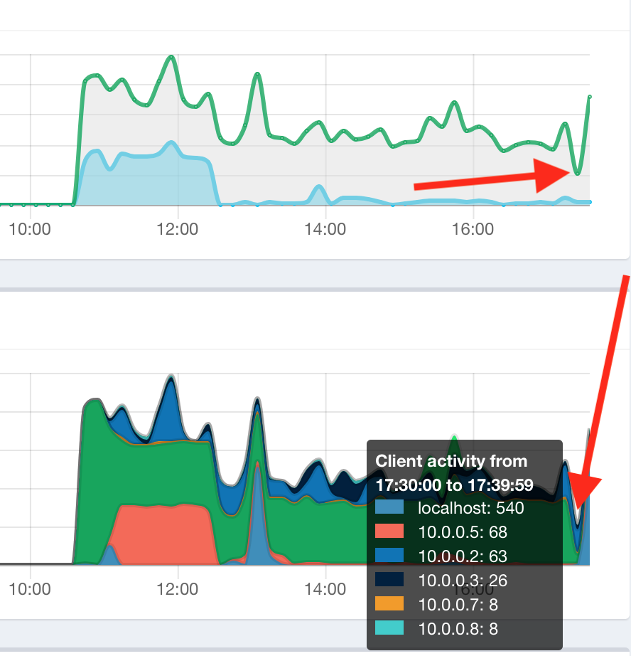

So ASUS routers send a few DNS queries every second to check if an internet connection is active or not... After I changed the WAN DNS from my Pi's IP to 8.8.8.8, 8.8.4.4, I noticed a downward spike in the graphs, but shortly, a spike in queries from localhost:
https://www.dropbox.com/s/zet59tucm2nxyk9/Screenshot%25202018-08-13%252017.46.29.png?dl=1
So I'm assuming that any DNS query the router will be making (like NS resolution for ping/traceroute) will be forwarded to the IPs set in WAN DNS settings?
