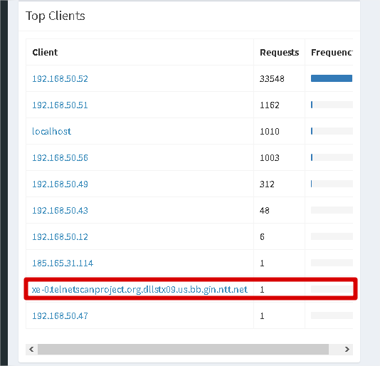

Hello there,
again my pi-resul scary me again.

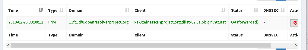

i closed all port from internet on my internet box
and i see this on pi*hole :
11fc5df8.openresolverproject.org xe-0.telnetscanproject.org.dllstx09.us.bb.gin.ntt.net
i really not understand how i can get IP like this on my home network
it's incredible !
if someone can please explain what that's mean ?
thanks
Port 53 open to the world?
Check also if port 23 (Telnet) is open.
