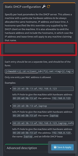

Then when I looked at the DHCP configuration for v6, the DHCP Static leases seems to have been reduced to a text-box entry with one address per line - have I understood this correctly? why? This seems a somewhat significant reduction in useability?
Whilst I could find and cut & paste in my Static DHCP leases, isn't this rather a retrograde step??

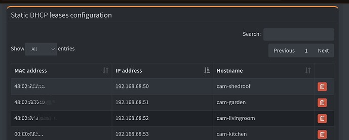

Okay, whilst I understand there are technical/operational reasons the Static DHCP leases have been reduced to just a text entry box, I am sorely disappointed by this.
The static DHCP leases is how I managed my LAN with all devices listed (even those with their own device based static IP assignment) and I could sort the list of assignments by IP or device name whenever I was checking out who had what IP & if there were any gaps etc etc. It also allowed me to manage IPs assigned outside the configured DHCP range.
Now, with v6, I'll find it very difficult to manage the list of LAN IPs (including those outside the DHCP range) as it's just a free-formatted & unsorted list of MACs/IPs/hostnames.

I went to my Pi-hole v6 beta & ensured the static DHCP leases edit-box was empty & verified this by refreshing the page.
I then used Teleporter to export from my v5 & import to my v6 beta - it completed successfully & the Pi-hole v6 static DHCP leases edit box was suitably updated.

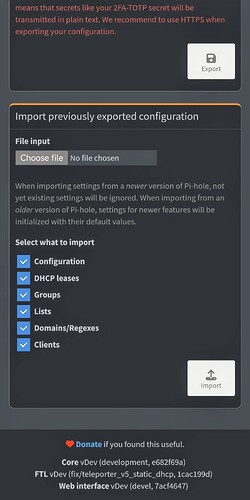

Okay, just tested using Pi-hole v6 beta Teleporter to export everything, wiped out my edit-box of static DHCP leases, and then re-imported everything using Pi-hole v6 beta Teleporter, and my static DHCP list was restored okay.

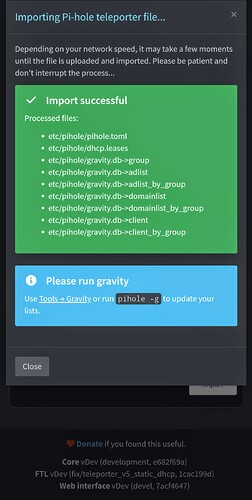

So export/import seemed to work fine - although the report of what Teleporter imported in v6 beta (see attached image) seems much smaller than what it imported from the v5 file?

I will think about what we can maybe still do about this. But maybe it is rather a v6.1 thing. Sorry about that... The more changes we do, the more often we again have to start over with testing and I finally want to push this through the door because I am confident that is improves in many many other aspects. A bit of debris can be cleaned up with a (probably rather quickly) following v6.1.
Yes, the content is now stored inside pihole.toml (more on this file below)
This is ensured because it all lives in pihole.toml now (again, see below :slight_smile: )
Yes, this is expected because pre-v6 we had all stuff floating around in many independent config files and their number has grown over time. Pi-hole v6.0 did a large consolidation effort and collected everything into the single-source-of-truth type of config file /etc/pihole/pihole.toml
