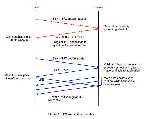

always requests TCPFO for incoming and outgoing TCP connections. The kernel will automatically do the rest (it may even ignore this request if TCPFO is not enabled, see below). The use of TCPFO cookies is transparent to the application level: the TCPFO cookie is automatically generated during the first TCP conversation between the client and server, and then automatically reused in subsequent conversations if TCPFO is enabled.

If it is 1
, then TCPFO is in client-mode (outgoing), i.e., you can use TCPFO to connect to others servers which support it (technically: you can read a TCPFO cookie).
If it is 2
, then TCPFO is in server-mode (incoming), i.e., others can connect to your server using TCPFO (technically: you can generate TCPFO cookies for others).
If the values is 3
, you can use both and TCPFO is fully enabled (incoming and outgoing).
