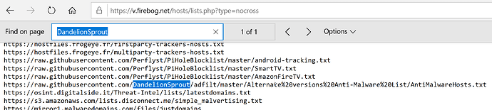

I mean ... oh boy. Thanks for letting us know. It is unbelievable how much crap content is out there...
I have, and probably many users , been using the firebog lists. Personally I use the Non-crossed lists (For when someone is usually around to whitelist falsely blocked sites).
I wouldn't call firebog dodgy, it's just unfortunate that entry slipped into a list.
