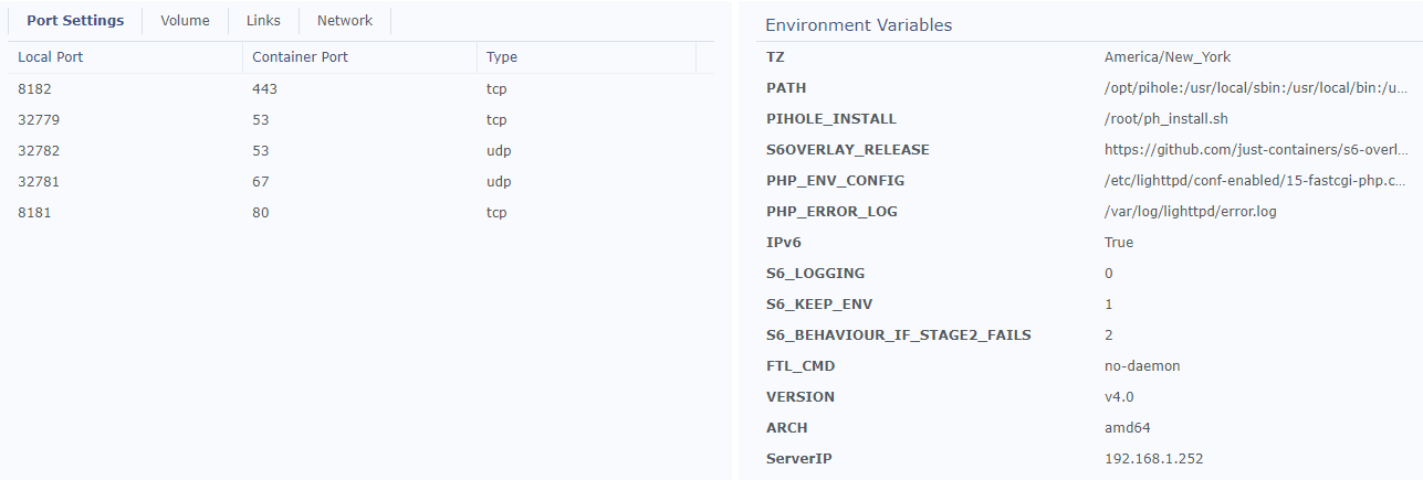

Current docker settings (which obviously can be changed):
The DNS port is getting forwarded to 32782, which is not the standard port for DNS queries. Try remapping it to 53.
I've never had a Synology to play with settings things up but I linked one of the more elegant solutions I've seen to avoid port 80 conflicting with synology's web interface : Alternative Synology installation method
Remember every time you re-create the container you're getting new random ports.
Thanks, guys! Forcing both the TCP and UDP ports to 53 seems to have worked.
