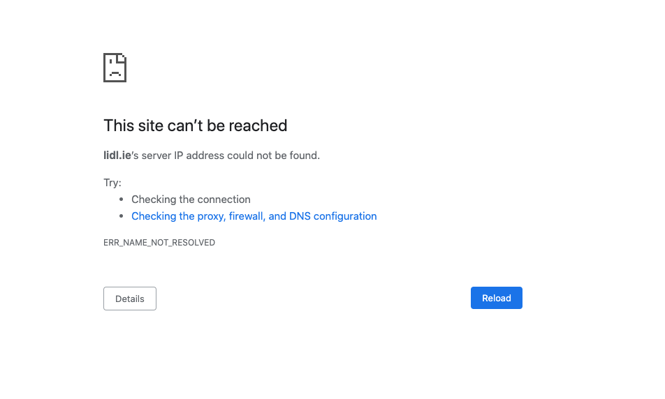

  2. Website is loading normally or partially
  1. every queries end up to time out

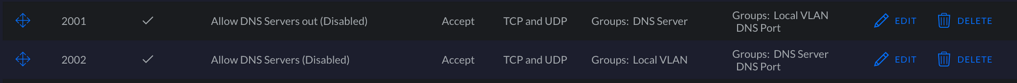

Firewall
  • 002 .Allow DNS Servers out : Accept TCP and UDP > SOURCE Groups:DNS Server DESTINATION Groups:Local VLAN, DNS Port
  • 2003 Allow DNS Servers : Accept TCP and UDP > SOURCE Groups:Local VLAN DESTINATION Groups:DNS ServerDNS Port
  • 2018 Block DNS Servers SOURCE Drop TCP and UDP Groups:DNS

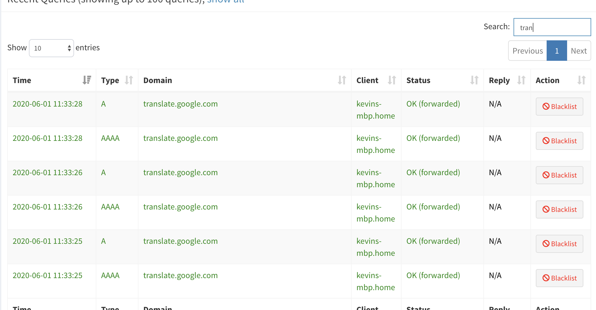

attached screenshots
Screenshot 2020-06-01 at 11.50.37

Who is in your Group Local VLAN? I guess the rule is for the DNS server (Pihole) to go out to the internet to contact an upstream DNS Server. The destination should be any (or paricular Upstream DNS-Server IP) but not something local?
Sorry for the delay, I'm using the Raspberry PI 3 since work just fine but I have the 100Mbs limitation (I have a gigabit WAN, but surely DNS request don't require that much anyway)
DNS server group : 1.1.1.1 1.0.0.1 , PIHOLE1, PiHOLETemporary.
Local VLAN (all the local VLANs and LAN IP)

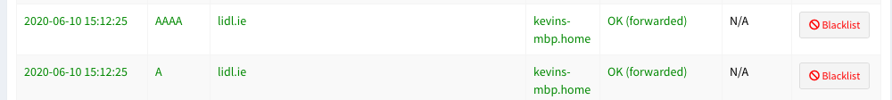

I changed to all but same result, still don't get it why PiHole seems to resolve the request on the UI
Try:
  • 2002 Allow Local DNS Servers out : Accept TCP and UDP > SOURCE Groups:Local DNS Server DESTINATION Groups: DNS Port
  • 2003 Allow DNS Servers : Accept TCP and UDP > SOURCE Groups: Local VLAN DESTINATION Groups:DNS Server DNS Port
Groups:
Local DNS Server: PIHOLE1, PiHOLETemporary
DNS Server: 1.1.1.1, 1.0.0.1 , PIHOLE1, PiHOLETemporary
Local VLAN: all the local VLANs and LAN IP
DNS Port: 53
In 2003 you could substitute "DNS Server" with "Local DNS Server" if you want to allow DNS traffic from your clients only to the piholes but not 1.1.1.1 and 1.0.0.1. The (outside) upstream servers for your pihole (1.1.1.1, 1.0.0.1?) should be covered with rule 2002 already
