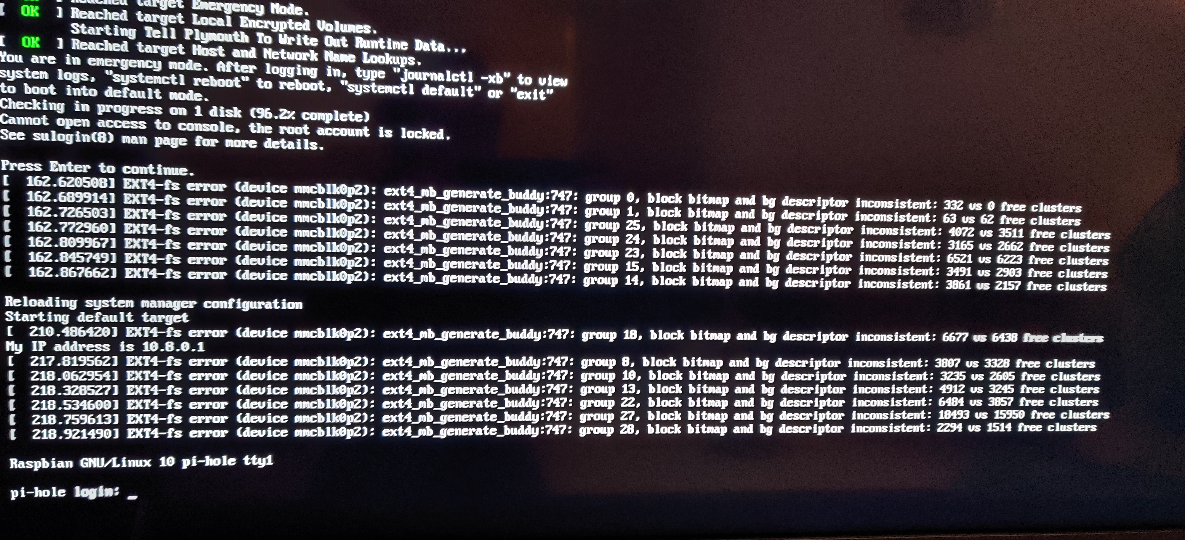

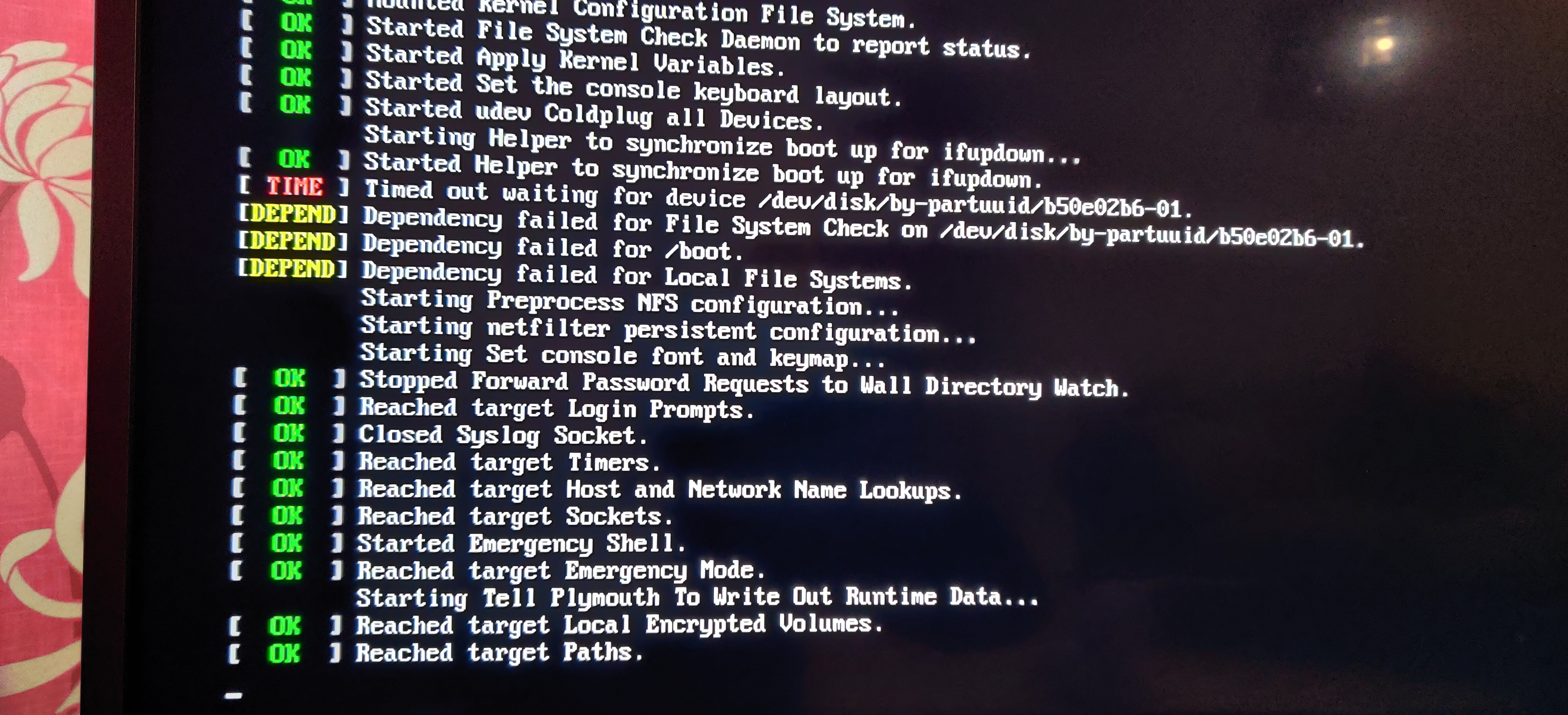

As a last resort I pulled the plug in the Pi and powered back on...which threw some errors. I've attached some screen grabs.

That looks like a badly corrupted file system.

I'd start with a fresh image.

If not, than your sd card may well be nearing its and of life.
No power losses to my knowledge, but I was out the house all day from 7am to about 16:30. So possible, although I normally get an SMS from my energy supplier.
I guess my job for tomorrow is a new sd card and image. Start a fresh install.
