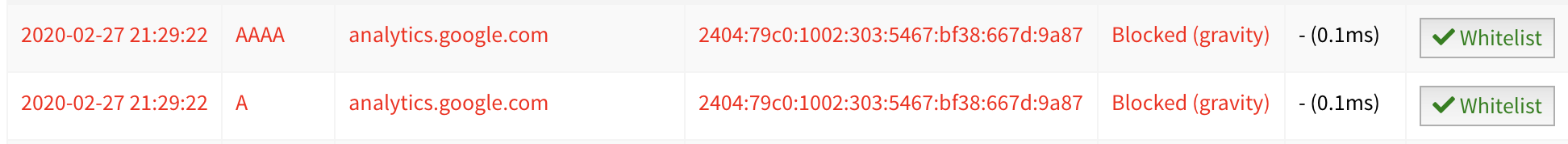

A group defined as a subnet - eg 2404:79c0:1002:303::/64
A domain is enabled for the group analytics . google . com
Requesting that domain still generates a 0.0.0.0 response
What is expected
Although the domain is in a block file - it should be allowed for requests within that domain.

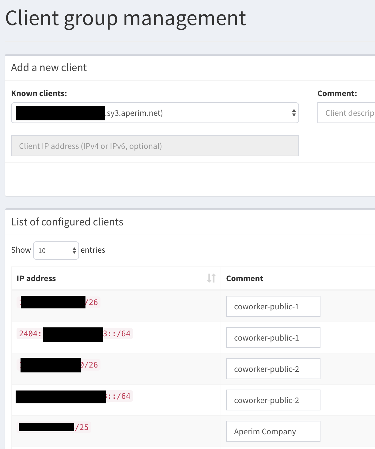

Where did you try to set up this subnet? Please note that subnets are not available at the moment anywhere in FTL, each client has to be specified exactly.
Defined in admin/groups-clients.php
There's no value (for us) in identifying hosts uniquely - perhaps the interface should reject subnets if they aren't supported?
Yes, adding validation for the IPs is WIP. Week ETA: next week.
You can submit a feature request for subnets and maybe we can work this out for some future version of Pi-hole. I don't think this could still go in v5.0.
