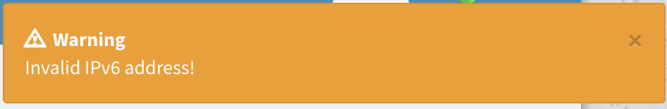

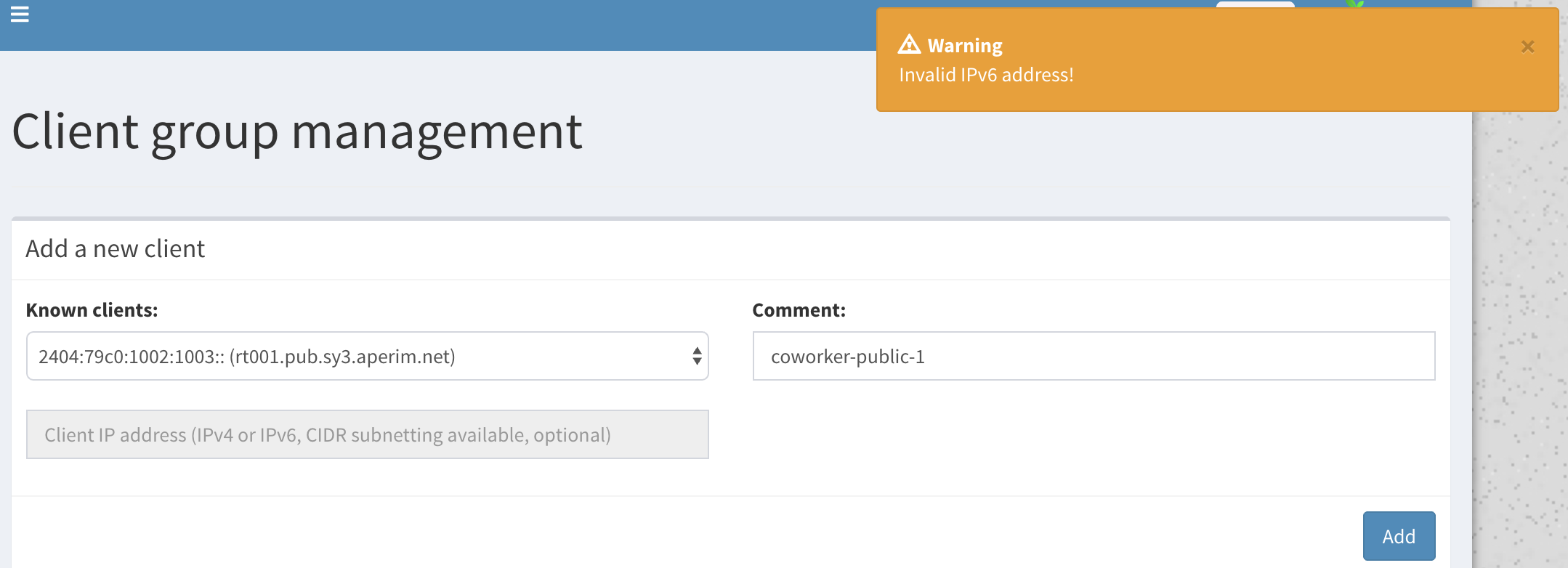

With the current release I am unable to add IPv6 addresses. Getting the following error:
Tested 2404:79c0:1002:1100::/64 and 2404:79c0:1002:1100::
Using the release or new/CIDR_clients both generate the error.
[Edit]

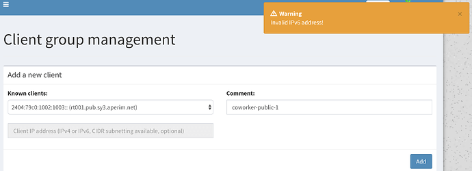

Updating even via the dropdown does not work for known addresses...
Neither of those are valid IPv6 addresses.
Hi @DanSchaper - yes they are both valid - one is a subnet, one is the router's IP
It just expands as 2404:79c0:1002:1100:0:0:0:0
Why do you think they are not valid?
Well, let's rephrase this to: "[...] unable to add these IPv6 addresses." :wink:
Not unable in general.
For the validation algorithm I invented was for IPv6 addresses, I forgot about addresses with trailing :: without anything behind them.
We discussed this before in here, but missed this kind of valid address type.
I already modified our validator, would you mind doing some more testing to see if we prevent any further valid addresses?
See https://regexr.com/50csn

https://github.com/pi-hole/AdminLTE/pull/1214
edit: @troykelly The PR has been merged.
