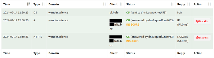

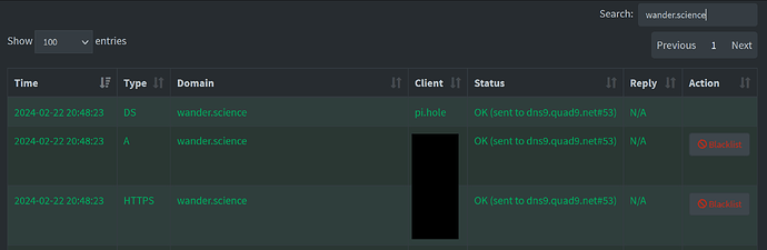

As those lookups are explicitly using public name servers, Pi-hole's DNSSEC setting would have no bearing on them.
Those time-outs would match the N/A replies for the DS lookup in your Pi-hole screenshots, i.e. the upstream DNS resolver has not answered that query (yet).
This happens if the upstream does not reply in time, e.g. if the upstream takes too long for the initial lookups. Consecutive lookups for the same domain could be expected to be faster.
Does your observation persist over several consecutive lookups?

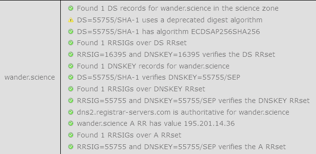

The zone is misconfigured.
So it's a... server side issue? I mean it's the service Pi-Hole links at http://pi.hole/admin/settings.php?tab=dns (and just the very first thing I tested once DNSSEC is enabled and that already fails...)...
If you depend on wander.science for reasons, you may consider to contact the domain owners/ maintainers and inform them that they are using an illegit digest algorithm to sign their DNS records, making it difficult to access their site with DNSSEC enabled.

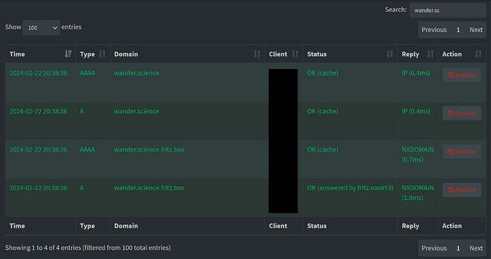

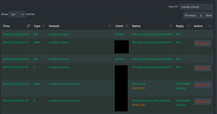

You are querying the domain wander.science but your screenshots showed that Pi-hole is querying that domain plus two other domains of the form
wander.science.<ext.domain>
wander.science.<int.domain>
At a guess, these appear to be possible intranet and extranet domains for a company. Why is your computer asking Pi-hole to query those domains? Is this a managed work computer?

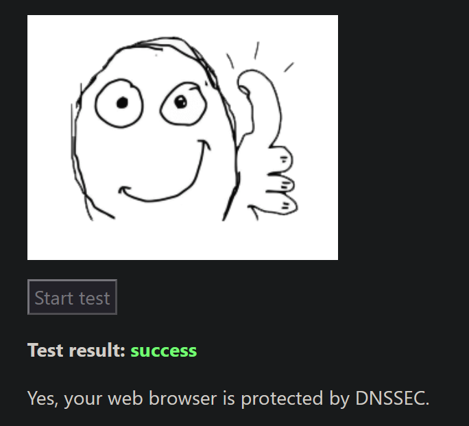

with DNSSEC disabled in Pi-Hole, I can surf at DNSSEC Resolver Test and run the DNSSEC Resolver Test ...which gives:
Not easy to understand for me I am sorry.

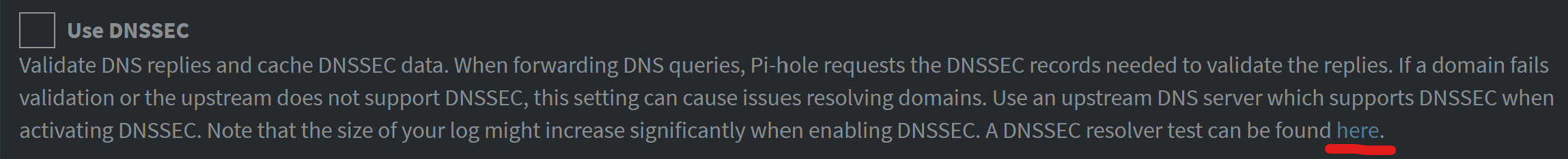

It is the DNS resolver that you are using which determines if DNSSEC is enabled or disabled. In the case of Quad9's 9.9.9.9, and Unbound configured as per the Pi-hole guide, DNSSEC is enabled.
The setting to which you refer is in Pi-hole's Settings > DNS > Use DNSSEC. This setting effectively means "make use of the DNSSEC information via the DNS resolver". If the DNS resolver does not support DNSSEC then it should be left off (it is off by default). If the DNS resolver does support DNSSEC then it can be left off or turned on. If it is turned on then Pi-hole displays additional queries and information about the DNSSEC status for all its queries. This also increases the amount of info being logged in Pi-hole's query database.
That is why you are seeing that result even when the Use DNSSEC setting is turned off – your resolver is still doing DNSSEC.

I concur with @chrislph that you are seeing the test passing because Quad9 does the validation for you. That's fine - but only in principle as there is nothing ensuring the reply wasn't mangled on the last path of the DNS queries life (Quad9 to your home). That's why I am running my own resolver locally.
