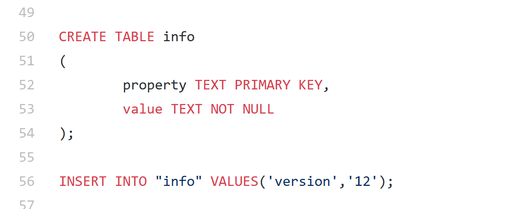

In pihole v.5.1.2, a new field (additional_info) has been introduced, so I assume the version number would be 2.
This would be identical to the versioning of the gravity database, the developers need to change the static version number, when a change is made, see here.

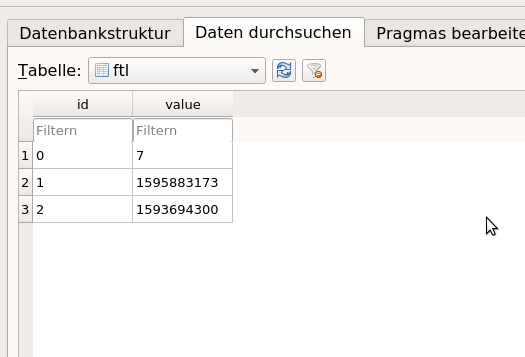

Thanks for making me think twice... it's already there :see_no_evil:
It's in table ftl id=0
I was just going to say exactly this. Looking into the file @yubiuser linked, there is an entire chain of updates to ensure you can update any version of Pi-hole to a newer one (not only 5.1 -> 5.2 but also 4.0 -> 5.2, etc.).
Actually a lot changed (like allowing multiple host names per client by moving them from per-MAC address to per-IP address basis, etc.)
The current version with v5.2 is 7
The version after having merged new/super-clients will be 9:
