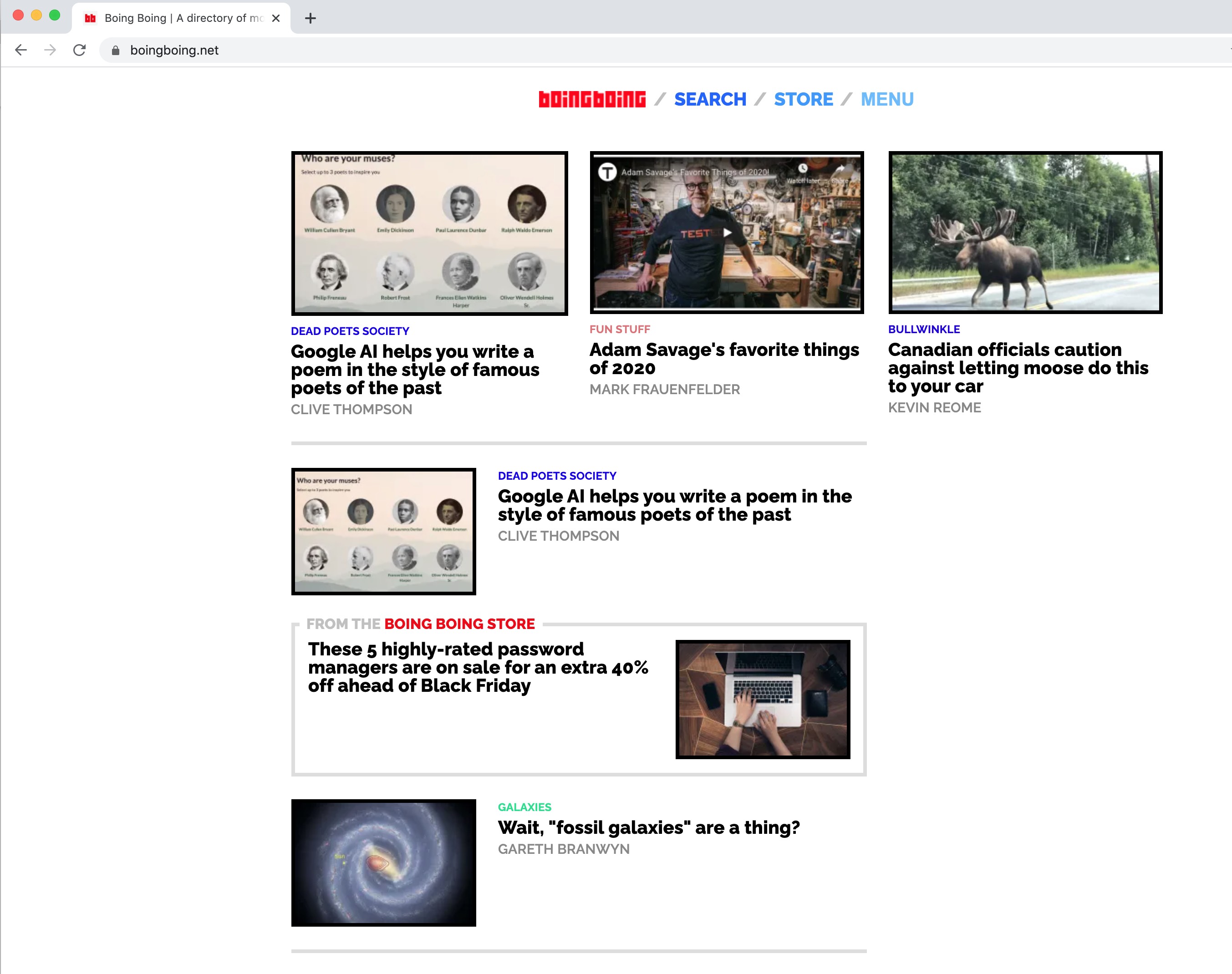

I'm not seeing anything other than the usual garbage articles on boingboing. Are there supposed to be ads on that site?

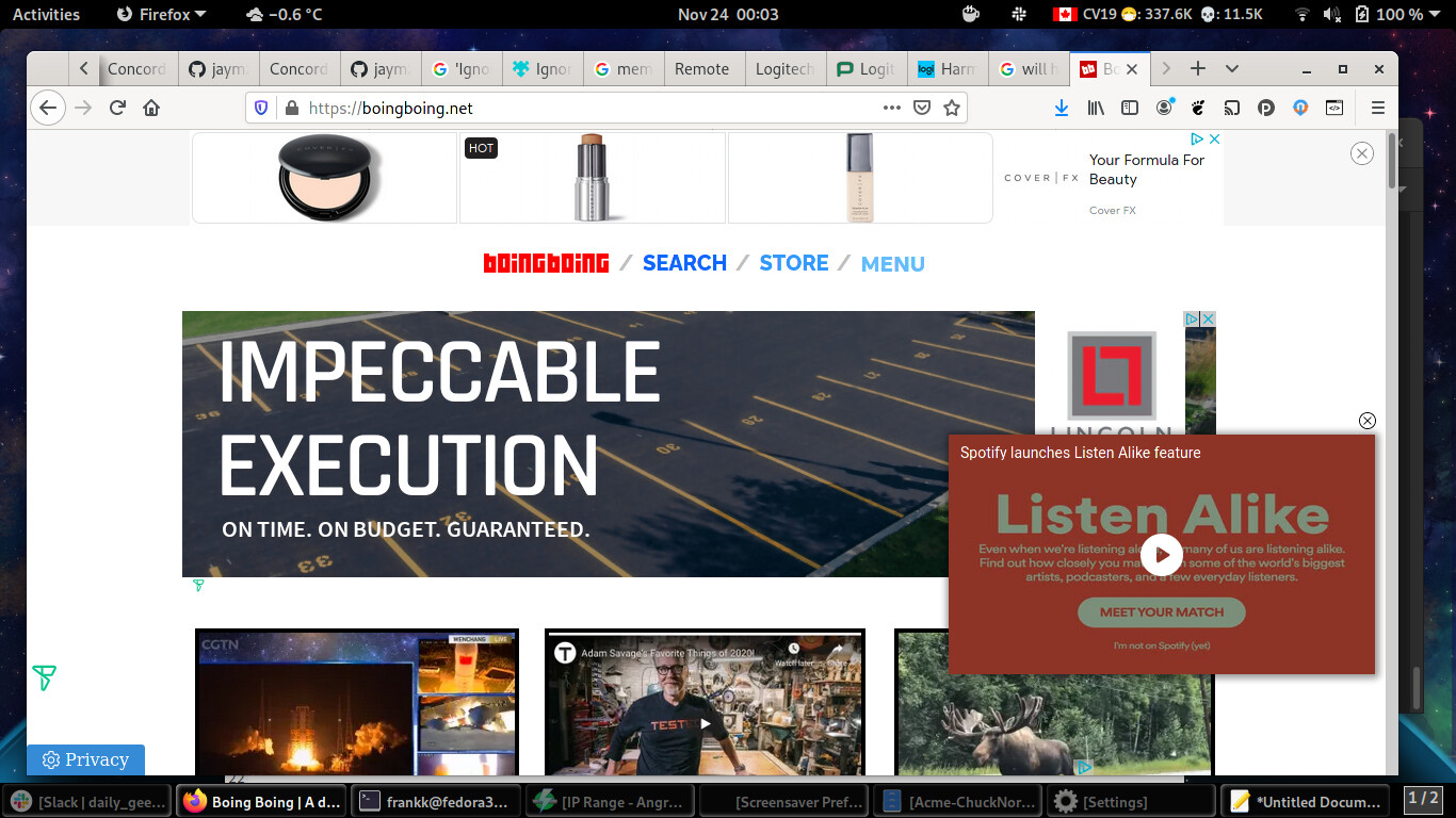

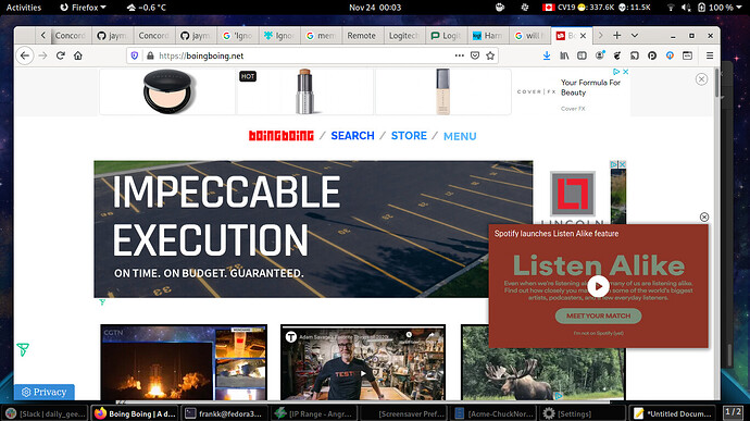

I'm getting a pageful of ads....
Attached is an image of the ads....
When I look at the source of the web page I can see they are using an add on (ad blocker blocker) package for wordpress which I guess their website is based on...
When I google that I found some software designed to get around ad blockers.... (German software)
I am in north america (Canada)
I also tried Chromium-browser and firefox both show ads......
Fot me pihole is not blocking anything... on boing ...
My/Your debug token is: https://tricorder.pi-hole.net/nhw6b8ojes
My DNS is correct and I just tried disabling IPV6 on my system and that didn't help either.....
