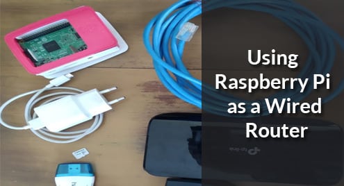

It sounds like you need the Pi to act as a gateway between the Starlink and Pi-hole, which may be what you were trying to do. Let the Starlink use whatever DHCP it has to assign the Pi an WLAN address (and DNS) in one one subnet and let the Pi run a DHCP for the other subnet with the gateway passing packets between the subnets. In the instructions below, you could ignore the part of "Configuring DHCP Server" if you enable DHCP in Pi-hole. The static for eth0 for the Pi should be the IP address for Pi-hole.
https://linuxhint.com/raspberry_pi_wired_router/
Or is your issue that you want to override the DNS for wireless devices that connect to eventually to Starlink. Then, you may need another wireless gateway with DHCP, which could be wired to the Pi using the above. Not sure if you can do a wireless to wireless gateway with a Pi. Two Pi's back to back feels totally conceivable.
After some "research," maybe add a USB WiFi dongle to the Pi. Then, you have two wireless interfaces, which should make a wireless to wireless gateway possible.

I used the web page you referenced as my guide to setting up the base system.
