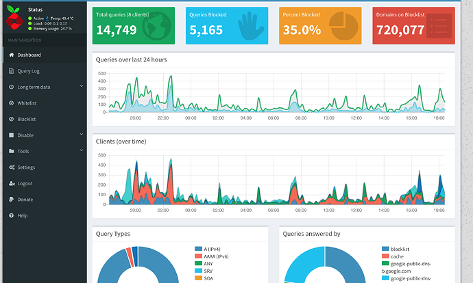

Its just a warning ![]()
Not sure, got stuck in versions and dependencies.
Other software installs might have done something like I noticed remnants of Apache.

This was probably solution:
sudo apt purge php7.0-json php7.0-sqlite3
sudo apt install php7.0-json php7.0-sqlite3
sudo apt install --reinstall php7.0-cli php7.0-cgi
sudo phpenmod json sqlite3
sudo service lighttpd restart
Cheers!
EDIT: For others that read this, it probably is sufficient to purge only the php7.0-json & php7.0-sqlite3 packages using dpkg -P and not pulling down other dependencies when running apt purge:
sudo dpkg -P php7.0-json php7.0-sqlite3
And try reinstall the two:
sudo apt install --reinstall php7.0-json php7.0-sqlite3
And proceed with the other steps above.
