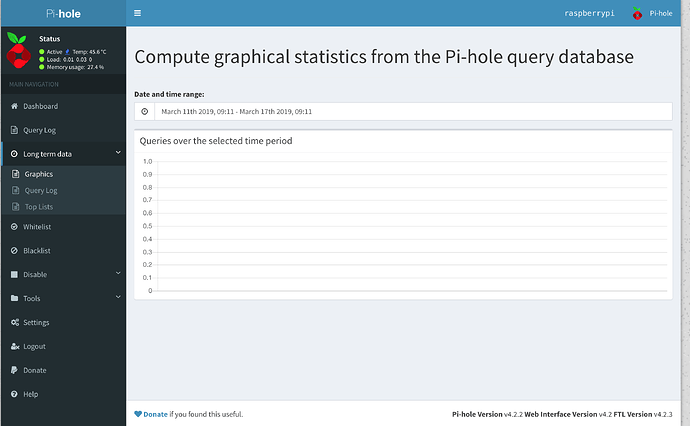

DeHakkelaar,

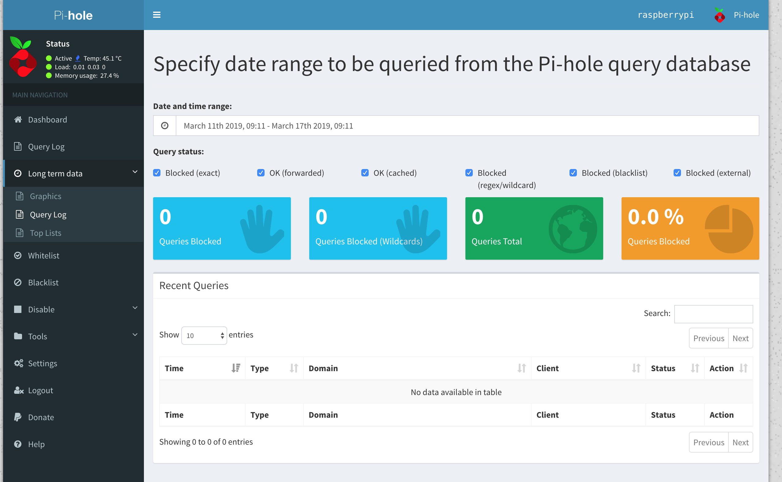

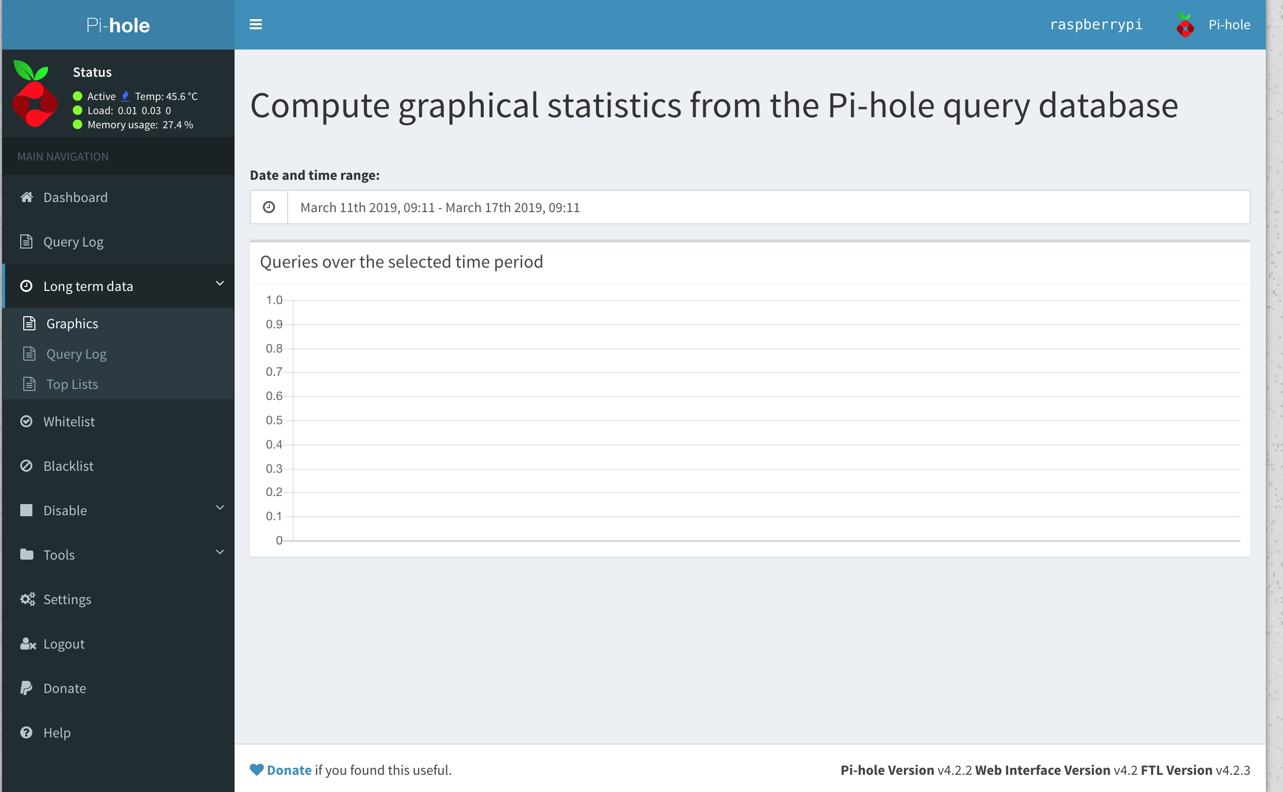

I have another issue which i have just discovered.

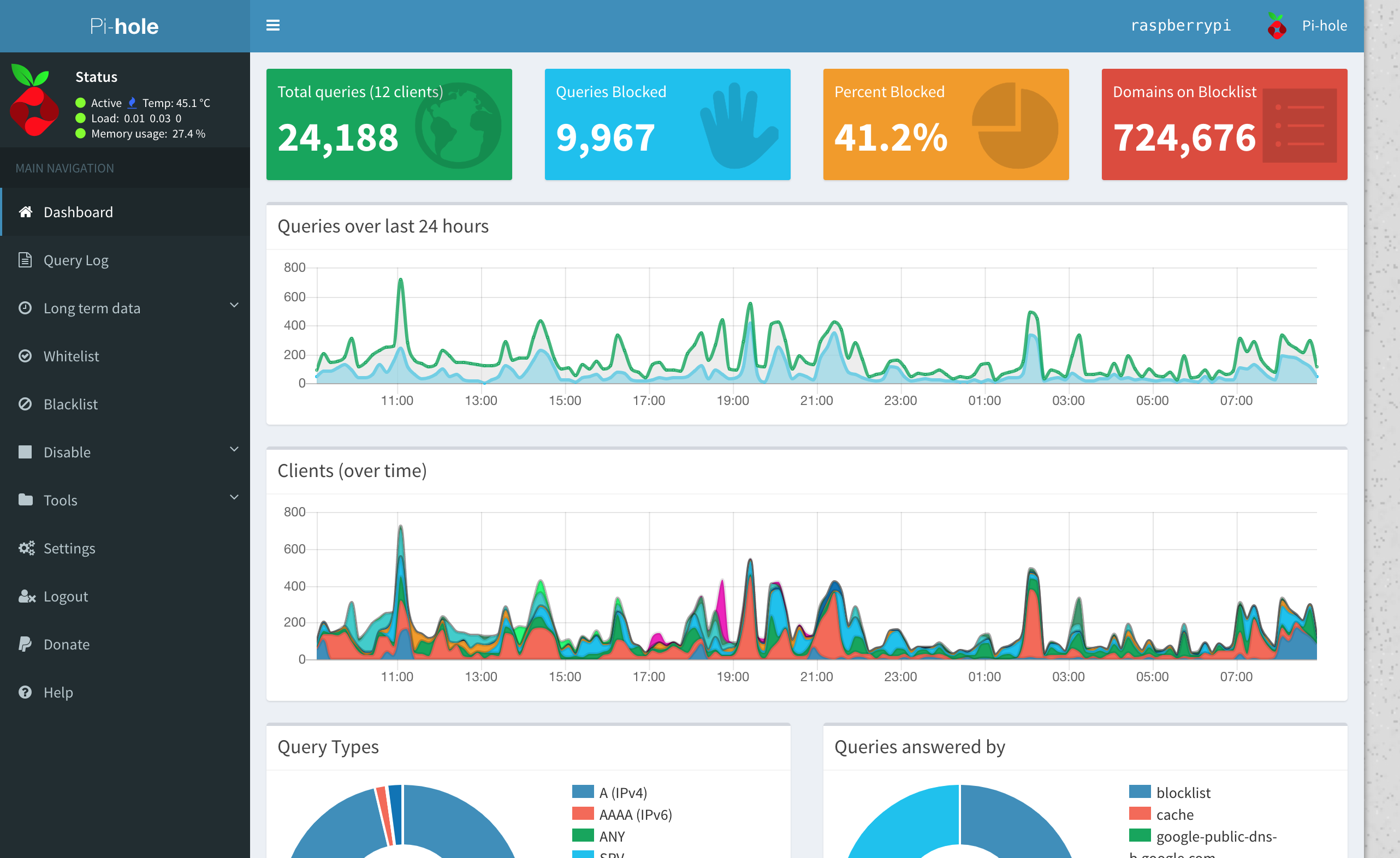

It seems my Long Term data is not populating even though my dashboard is.
Screen shots.
I have followed all the advice from this post
This is the output from what i have done.

It hasn't fixed the problem. Can you offer any advice?
