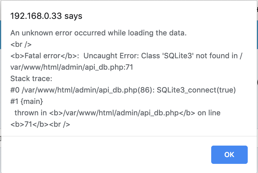

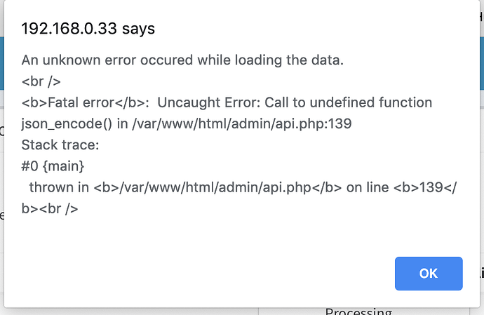

SqLite3 and json_encode() fault
I am unsure of the expected behaviour but i expect to see logs when i click "Query Logs". However what i receive is a pop up message showing some errors.

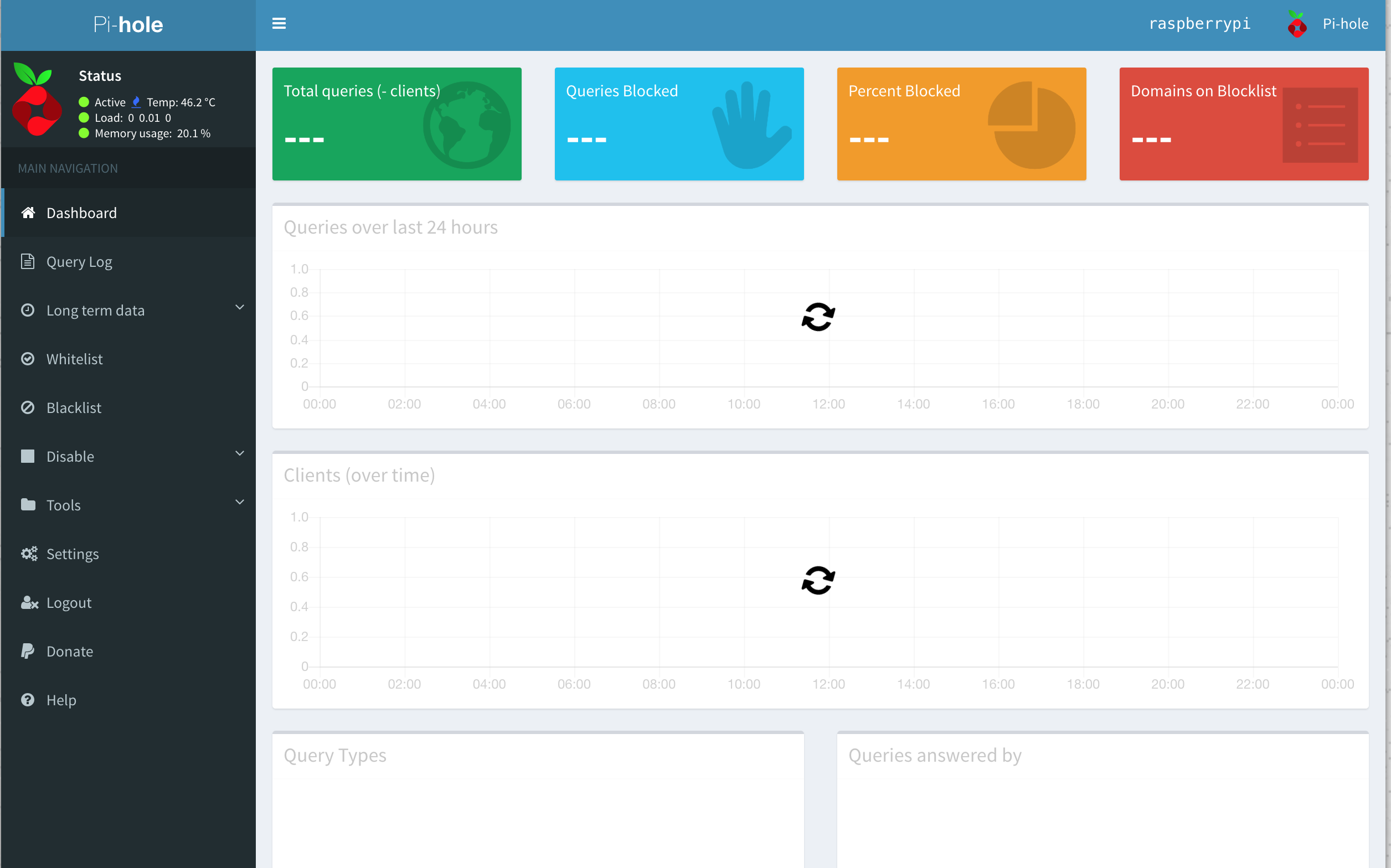

My dashboard also doesn't load. I have tried multiple browsers with no success.
SqLite3 not found found and dashboard does not load.

You will need to install sqlite - this thread may have a solution for you: Blacklist and Whitelist not working - #11 by Mcat12
Excellent thank you. However it seems after following the advice that is not the problem.
my output was the following:
pi@raspberrypi:~ $ sudo apt install php-pdo
Reading package lists... Done
Building dependency tree
Note, selecting 'php7.0-common' instead of 'php-pdo'
php7.0-common is already the newest version (7.0.33-0+deb9u3).
0 upgraded, 0 newly installed, 0 to remove and 5 not upgraded.
pi@raspberrypi:~ $ sudo apt install php-sqlite3
php-sqlite3 is already the newest version (1:7.0+49).
pi@raspberrypi:~ $
any other ideas?
What is the output of these commands?
ls -l /etc/php/7.0/mods-available/
cat /etc/php/7.0/mods-available/json.ini
cat /etc/php/7.0/mods-available/pdo.ini
cat /etc/php/7.0/mods-available/pdo_sqlite.ini
Mcat,
thanks for jumping on this.
pi@raspberrypi:~ $ ls -l /etc/php/7.0/mods-available/
ls: cannot access '/etc/php/7.0/mods-available/': No such file or directory
I take it that is the problem?
What could have caused that?

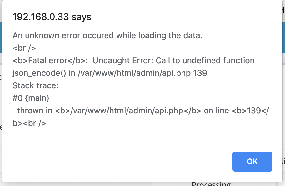

Below one will reinstall the two PHP modules and restore the /etc/php/7.0/mods-available folder:
sudo apt install --reinstall php7.0-json php7.0-sqlite3
And below one should enable the mods and create appropriate symlinks:
sudo phpenmod json sqlite3
After reinstalling and enabling, post outcome for all the commands from my first posting pls ?
EDIT: And post outcome for below one just to be sure ?
php -m
EDIT2: after enabling the two mods, you most always have to restart the web daemon to apply:
sudo service lighttpd restart
Edited. New output to follow
sudo apt purge php7.0-json php7.0-sqlite3
sudo apt install php7.0-json php7.0-sqlite3
And the commands from my first posting ?
