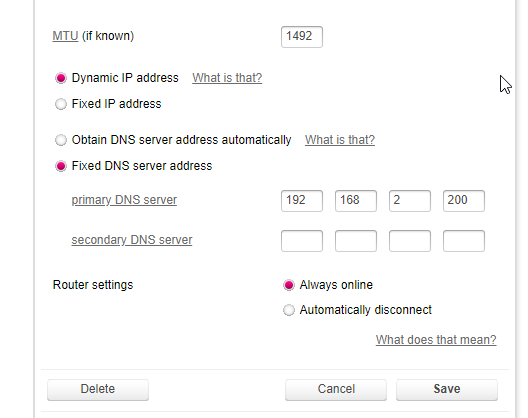

Don't use primary/secondary DNS or a backup DNS. That's why things randomly work, sometimes you are using the Pi-hole and sometimes you are using Google.

As noted by @dschaper, your problem is not with Pi-Hole, but with the fact that some of your DNS requests are bypassing Pi-hole.
Get rid of the 8.8.8.8 DNS in the router and all your DNS traffic will go through the Pi-Hole.

That client is manually mapped to the Pi-Hole. What is the result if you check "Obtain the DNS server address automatically" and apply that setting? That will show the DNS that is being provided by the router during the DHCP handshake.
That will unfortunately get me semi-offline again where I can't reach any website
What is causing this? When you get the DNS automatically, what DNS are shown in the Windows box with ipconfig/all
Your router is passing itself and an IPv6 DNS to the client, and not the Pi-Hole DNS address. If you aren't using IPv6 on your network, I would disable that on the router and clients. That has frequently been a source of DNS bypass around Pi-Hole.
