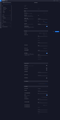

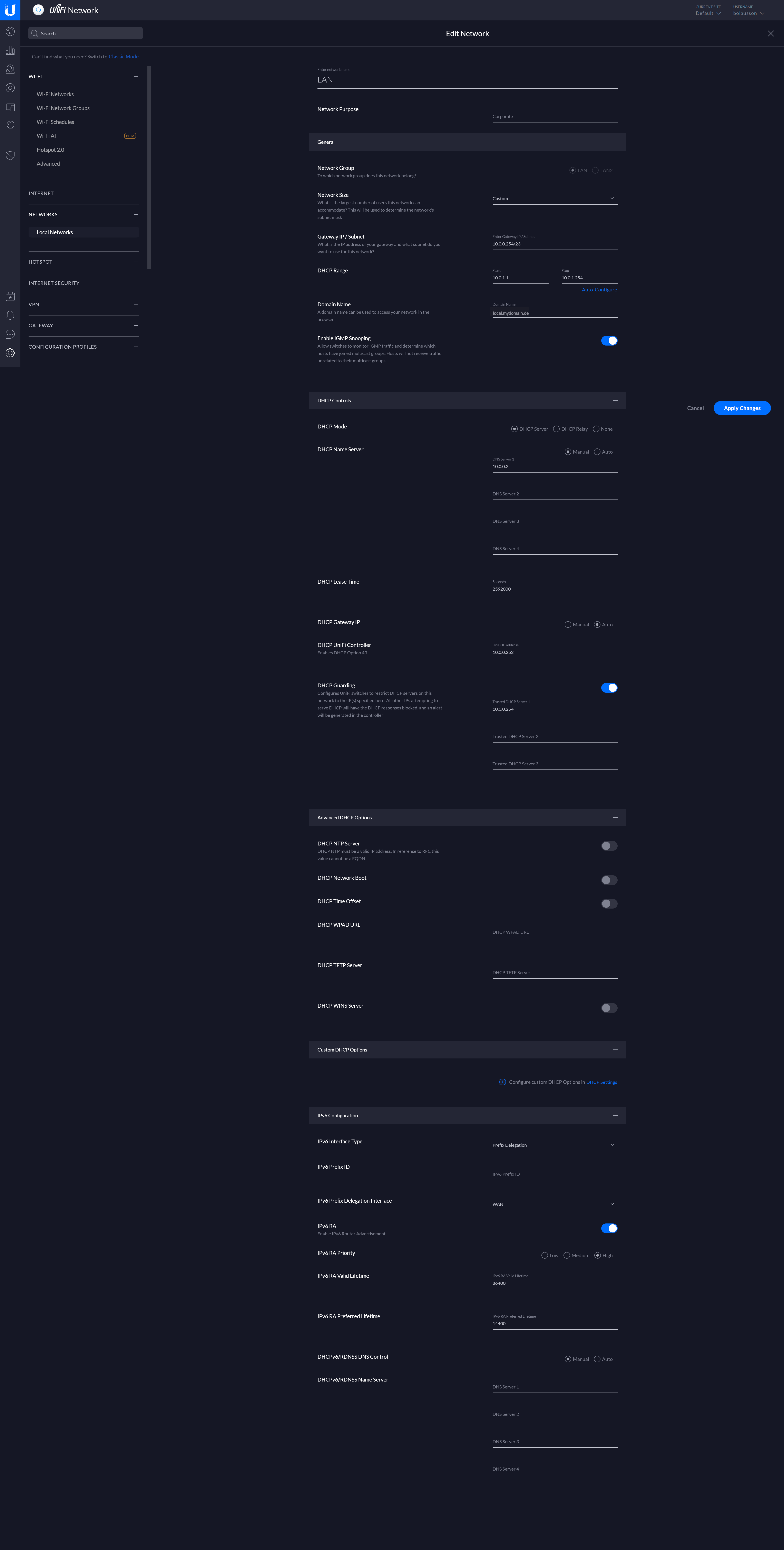

And here is a screenshot from my UniFi USG 3P router. The domain-name is set to local.mydomain.de:

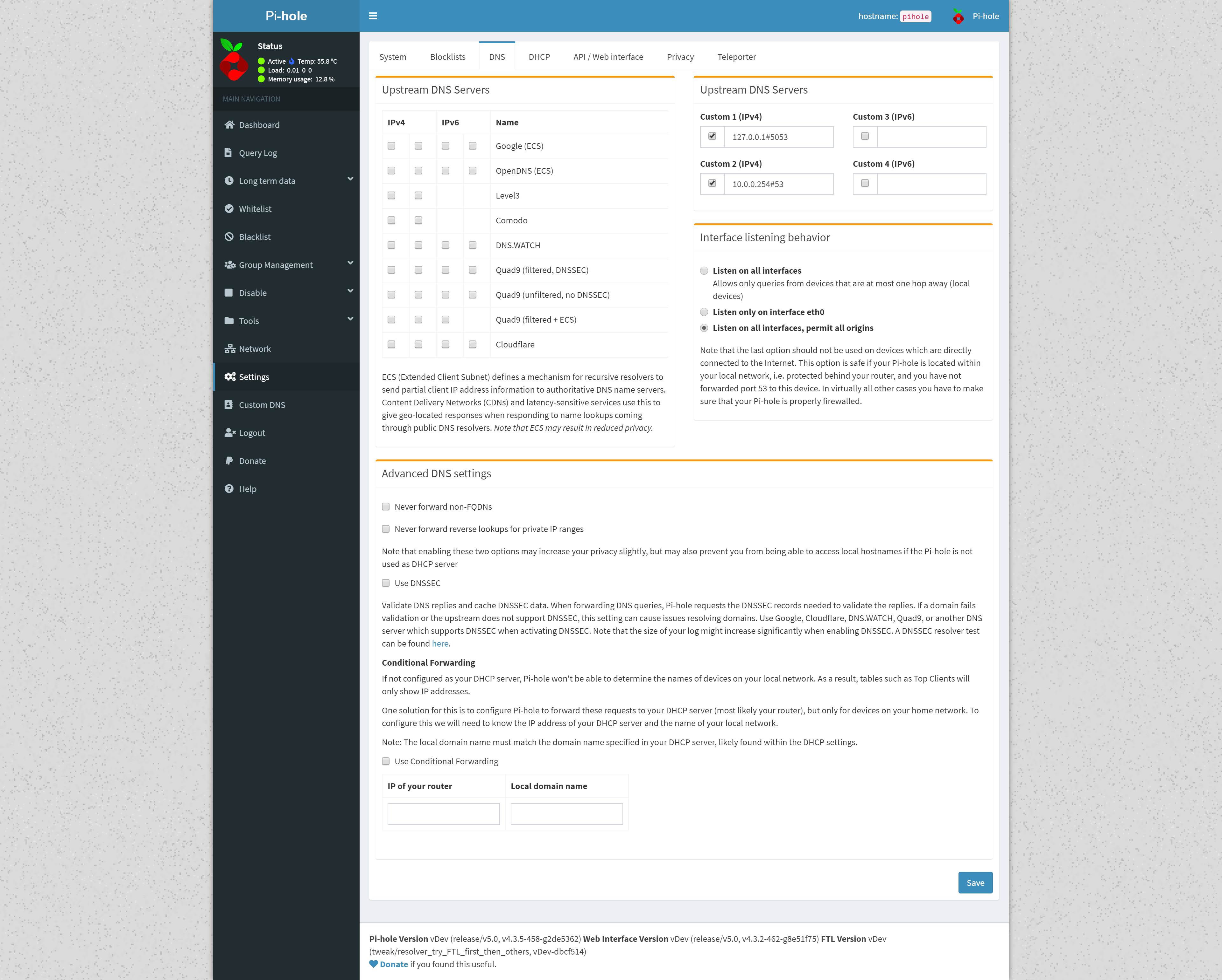

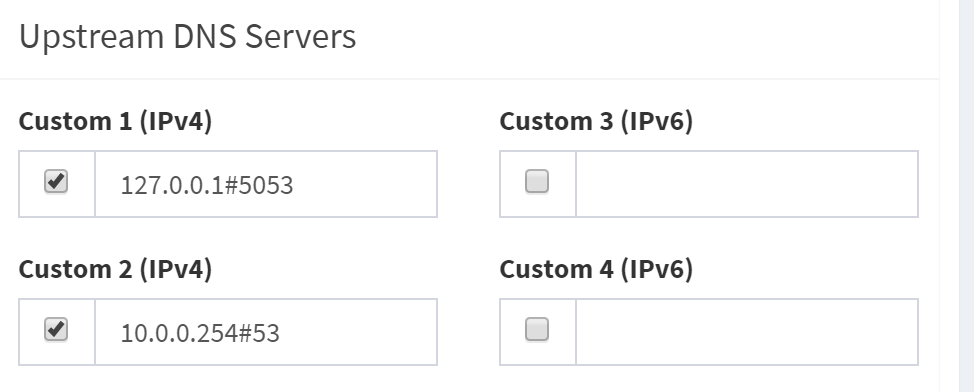

You may try setting up your router as Pi-hole's sole upstream - with Never forward reverse lookups for private IP ranges unchecked - instead of using Conditional Forwarding , but will then have to control final upstream DNS through your router's settings.

I did setup DNS-Over-HTTPS as described here: Redirecting...
Does this interfere?

I am now just wondering, do I have to add my routers/DHCP IP as "Custom 2 (IPv4)" or not?
Cheers,
Bjoern
Just tried to remove it from “Custom 2 (IPv4)” and I can't access anything on my local network by hostname and no local clients are resolved on the dashboard so it seems to be mandatory that my router/DHCP is set in “Custom 2 (IPv4)”
gpb
April 9, 2020, 2:29pm
54
No, you don't need the router address here...it goes in the Settings | DNS tab.

Well, I tried to remove it and as said, its not working with this config on the Settings | DNS tab it works fine:
gpb
April 9, 2020, 2:43pm
56
Check "Use Conditional Forwarding" (bottom of page) and add your router IP and the domain name for your network (typically "local" or "home" or whatever yours is).
Indeed, this now works as well
mine is local.mydomain.de (where mydomain is just a XXXX for my real domain name)
