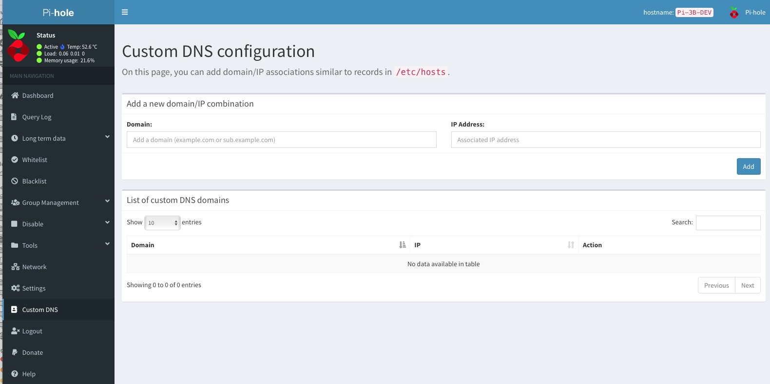

Also, can you tell me the location of the Custom DNS script so I can change the default lines from 10 to 100? As mentioned earlier I don't see it in the folder where all the other pages are defined (that is, the contents that fill the drop-down with "10, 25, 50, 100...

Are you not seeing this pull-down for number of entries to display?
A post was merged into an existing topic: Request: Ability to add clients to known client list from Network page
@jfb I see the pull down on the page, BUT I can't find the script file so I can adjust the contents of that pull down from 10, 25, etc to 100, 250, etc. as I prefer to see max when I visit a page. I created a script that updates all the other pages after each pihole program update but can't even find where this script file is located for the custom dns page. Thanks!

https://github.com/pi-hole/AdminLTE/blob/release/v5.0/scripts/pi-hole/js/customdns.js#L42-L64
It isn't defined here as it is on the other pages so the default kicks in. I want to overhaul the Custom DNS page at some point but no promises I will get to it soon enough...

The Custom DNS page...yeah no problem at all...was more curious as to why I couldn't find it. Thanks!

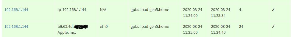

@DL6ER
Edit: Although I do see a duplicate for my iphone now. One has interface = N/A (no MAC address) and the other has Eth0 and normal looking. Both have some queries.
Just flushed tables again and now my ipad has the same situation as iphone (iphone entry is fine now). Maybe it's a timing issue...the ipad in this case showed up before the actual valid entry did...then the valid entry showed up properly (and thus duplicated entries as described for iphone above).
Could you share a screenshot so I can see the Last Query fields, whether the IP fields are identical, etc.?
Sure thing:
It's not entirely clear to me why this is happening. Can you flush your network table and check again if the duplicate appears?

Guessing here...it looks like a timing issue. What I mean is...when I flush the table (using the gui), returning to the network page, the first thing I see are no rows. Clicking repeatedly, they populate in groups and the first group contains the non-MAC ID record, then followed by the correctly resolved MAC ID record (duplicate). Not sure if that helps pin it down.
Testing again just now (using GUI), flush table, click and zero rows display. Then nine rows, six devices on my primary LAN (the iPad showing no MAC ID again but no duplicate record yet) and three rows of my VLAN devices. The table continues to fill in over time. The first rows fill in after just a couple clicks...so within 15 seconds of flushing. Could this be related to the mock issue from the other thread? This did not just show up from your last code change, I noticed it just before that as well (before I mentioned some devices were showing N/A).
Testing again, this time I get four devices that are now missing MAC IDs (and all become duplicate IP records). Sixteen devices populating the first group (while clicking Network repeatedly...obviously even though that's what I'm seeing there could be multiple iterations of building this table occurring behind the scenes).

I wonder if flushing from the dashboard does more than just flushing the network table. It might also flushe the neigh cache itself. For now, please try with this sqlite3 command.
Okay, so this means the client is (initially) not in the ARP cache (assumed it was flushed, see above), FTL added it as it thought it was a client not directly connected, then it comes up in the ARP cache and FTL adds it as non-mock device.
This only seems resolvable with FTL checking if it already recently created a mock-device for a new ARP device it wants to add and converting this over. This will be ... difficult ... to add, at least.
