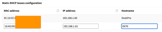

[SOLVED] How can I get the local domain name auto suffixed to hostnames in DHCP?
  1. Devices should be reachable via <device_hostname_from_DHCP_reservation>.<local_domain_name>
  2. I should be able to define DHCP lease reservations based on MAC address and host name. At this point, I should not need to add the local domain name suffix, since the server already know what domain name it is assigned, e.g., .lan
  3. When these devices get their IP address, they should be discoverable using <device_hostname_from_DHCP_reservation>.<local_domain_name>
In the above example, I am assigning the name DX70 to the 2nd device. Instead of having to type DX70.lan, I should simply be able to type DX70, and the servers should auto-add .lan at the end in its configuration.
  1. I need to add per device DNS records to be able to use <device_hostname_from_DHCP_reservation>.<local_domain_name>.
  2. I can use <device_hostname_from_DHCP_reservation> to find the device.
  3. I cannot use <device_hostname_from_DHCP_reservation>.<local_domain_name> to find the device.
